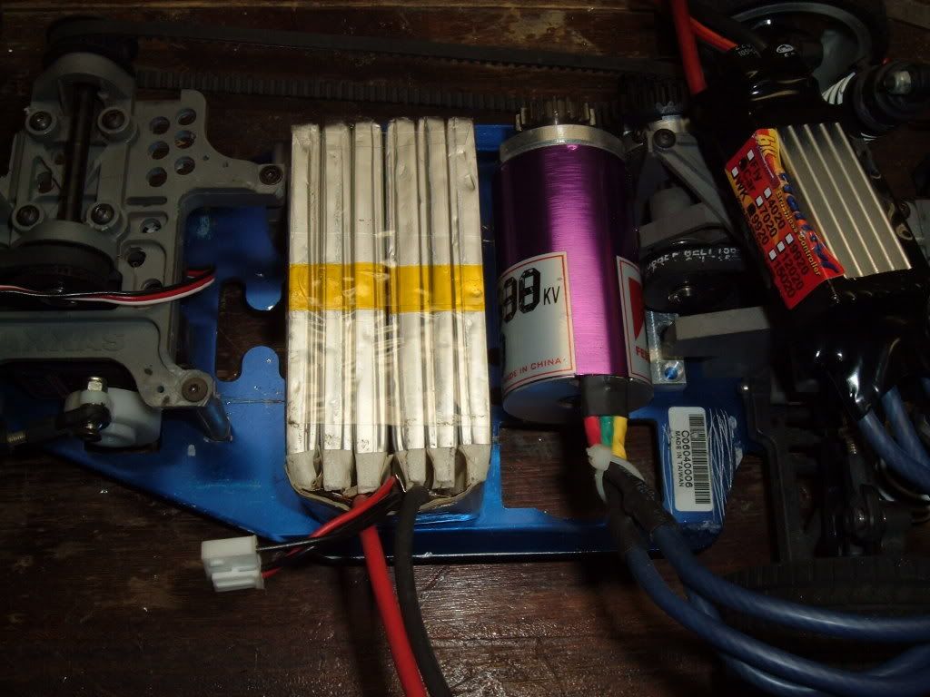

Here is a snapshot of the chassis layout showing the plans. I tried to get a shot of the ruler to show how much room there is for the motor, but there was too much of a glare.
Sorry about the picture quality, it was taken via my cell...

Looks good Brian. I like how you re-mounted the servo. Must be tight for the linkage going under the front upper deck.
I got the motor mount in and put the center belt back on on mine. Looks like I have enough room to run 6s 2100 maxamps lipos, and I have that many "matched" cells (or at least what maxamps calls matched) so I may have to swap in a quark and give it a try. I will stick to a 5s pack at the moment, and see how it does. 5s and 20/41 gearing give me around 65mph, so we will see how this turd holds up to that.
