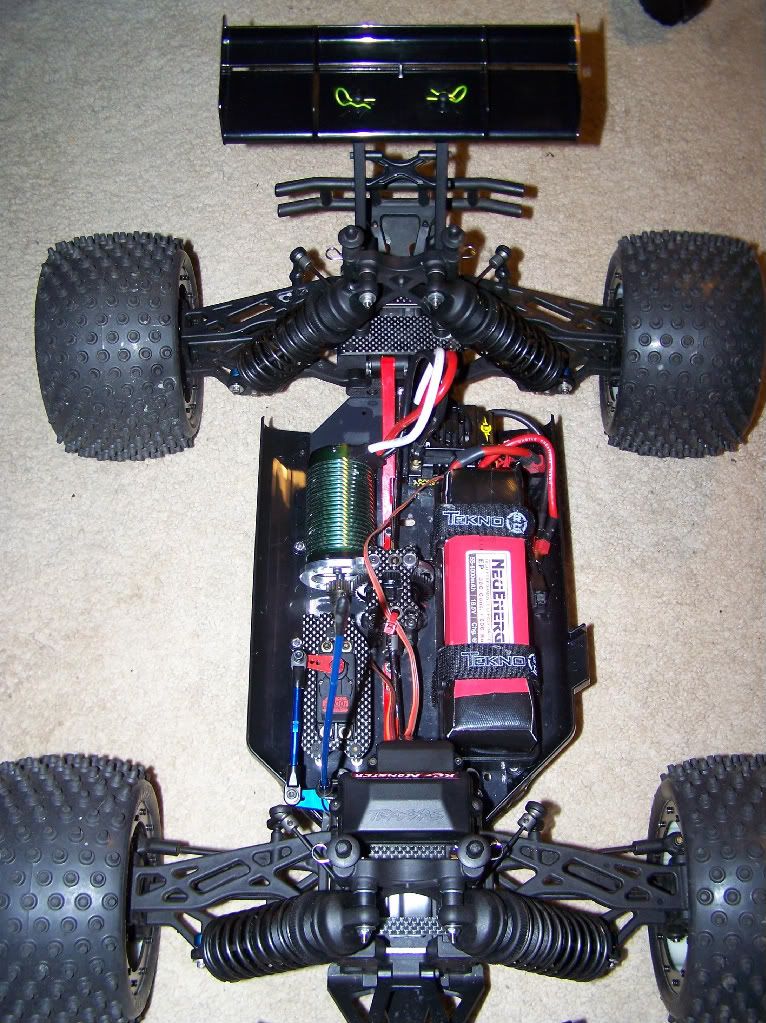

I just got the muggy running finally about a week ago. MMM/2200/5s neu 30c... 46(plastic kyosho)/15, 9100T servo, CF kit. It was a well used nitro, 1 bottle of simple green later, rebuild shocks, cleaned grease out of diffs, put them in Silver (aftershock ?) diff cases with heavy duty diff cups. 10f/30c/7r weight. The truck is the fastest 1/8th I have it is a 4 wheel drive tank, nothing can stop this thing. Smokes the 8Ts 1.5d on 4s, smokes the 2D on 5s in the Gmaxx. I have the shocks set up with pretty thick oil around 75w. Perfect for my bashing. The 2200 holds up really well no heat issue, but its not over 40 here on a good day this time of year...Find out when summer rolls around.

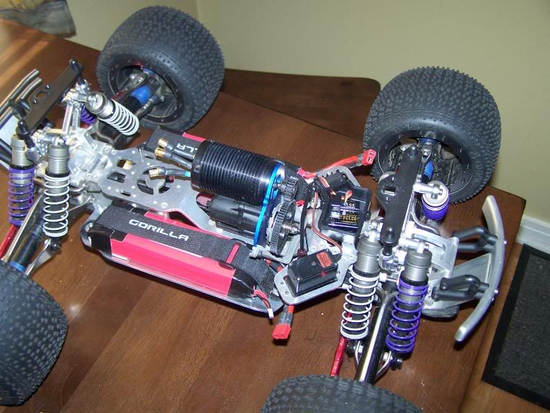

Put all the trucks next to each other and the 8t and muggy have the exact same wheel base and the maxx is only a couple MMs off. Thought the Muggy was huge when building it
