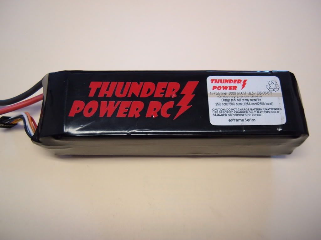

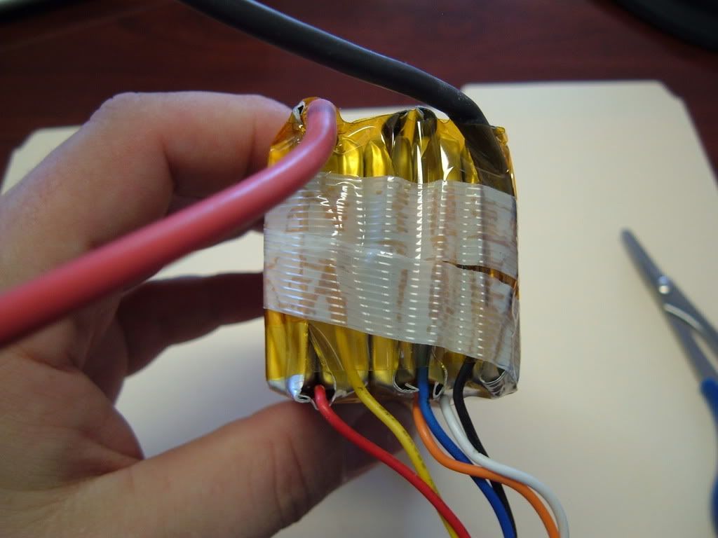

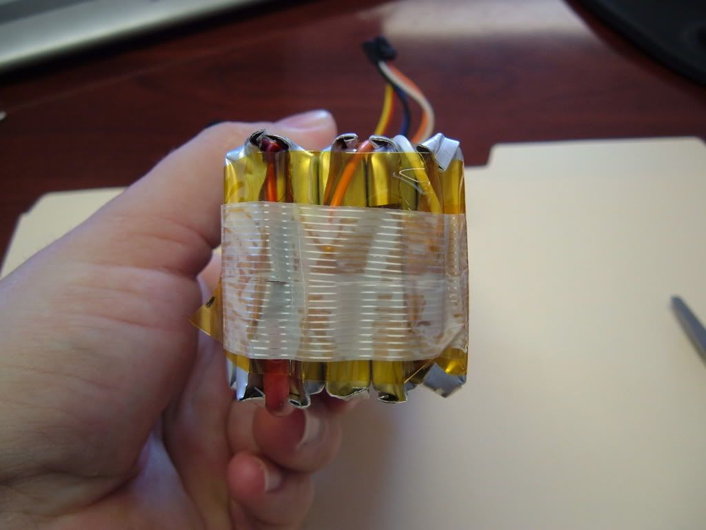

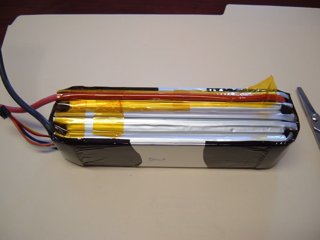

Since it has been a while since I posted some pics, I figured that I would photo document splitting up one of Skellyo's 5s packs into a 3s and a 2s pack.
Pack is a thunderpower 5000 5s 25c pack. Cells are enerland manufacture.
Heres a few going into the disassembly phase. Note that enerland cells have a large tab on each end, instead of side x side as most chinese (maxamps inc) cells do. The tabs are al, but are very thick, and at least twice as wide as a maxamps pack. I will scare up a maxamps cell and take a comparison pricture. Also note that the cells are arranged in series end to end, so on odd number cell packs one of the main leads must run down the inside of the pack in order for both main leads to exit at the same end. Also note the colorful tp style tap. Both thunderpower and flightpower use the same style tap, only the wire colors differ.

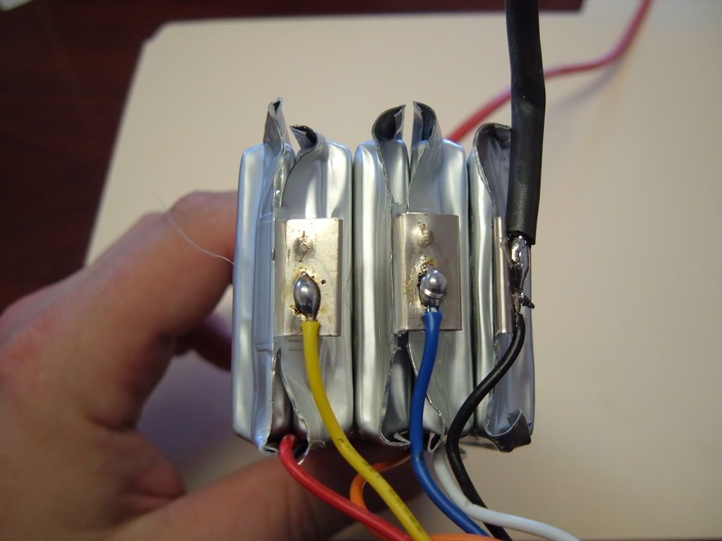

03.10.2009, 12:34 PM
A few shots of the bare cell ends:
