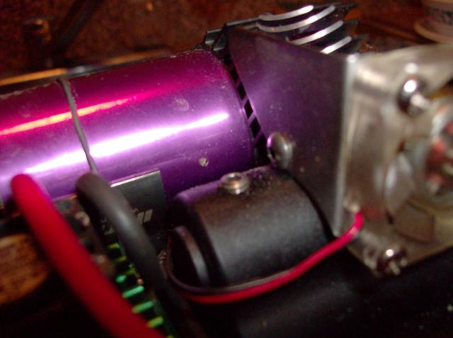

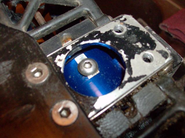

Not the best pics, but here is the 10-32 setscrew on the top of the front half
of the trans, and the bottom of the rear diff with a 10-32 button head screw.
