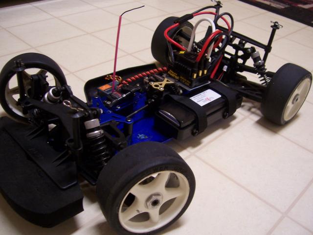

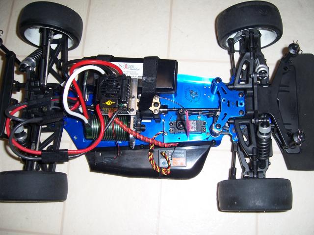

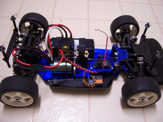

I finally finished my car today!!! I'm so happy now. It seems a little slow so I think I'm gonna mess with the settings a little.I just wanted to say thank you to everyone here who helped this noob to 1/8. I have been in R/C for the past 23 yrs but this is my first 1/8 brushless.Big thanks also to monsterMike for all the excellent products and top notch customer service!!! I love this site and look forward to remaining a member for years to come.

Looks nice..well done
04.03.2009, 08:05 PM
Awesome! Gear up for more speed, that motor is a torque monster. Keep track of the temp and stop gearing up when temps rise. Later!
04.03.2009, 08:07 PM
Nice - A tip for you though - put the braces back in before you run - You will have a lot of flex without and it will hurt the mesh and maybe even the motor...
