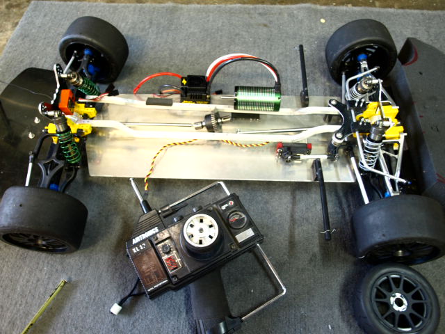

I have a custom ride here and want to know if there will be wheel spinning upon take off and still not over heat things? Or will I have to gear so high inorder to keep RPM down that it will not peel out ?
10lb 1/5 custom losi direct drive, CD locked and rear locked, using a MMM, CC2200 and looking at buying a PQ 6s 6000 25c lipo 120 amps
I'm guessing a final ratio of 8:1 or so ? would be plenty for torque and speeds in 45+ 50mph
wheel base is 21"
Any recommendations here ?
Thank you very much

What size pinion gear are you using? You are currently set up for about 77mph (3.5vC, 2200kV, 4.5" tire). However you will still be able to spin your tires without fail. Just be wary of the jack-rabbit starts (with that gearing) or your MMM will say "Screw this!". Get it rolling a bit before you punch it.

First, I assumed a 4.5" tire diameter based on the picture. Then I assumed a WOT loaded voltage of 3.5vC (21V).
