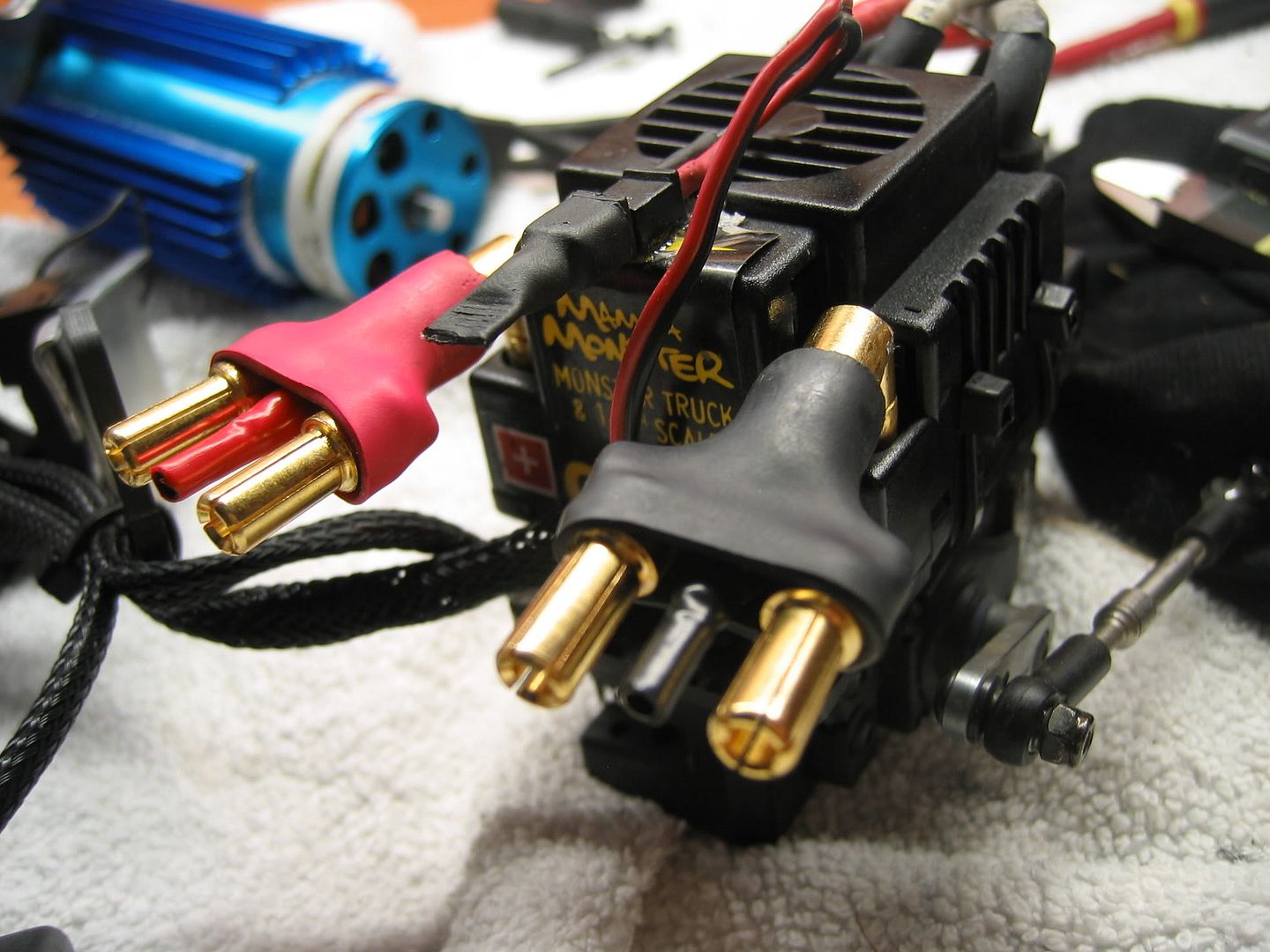

Here is something i came up with, removing esc battery wires, as mine has still plugs.
Havent tried it in truck yet, to see if it will work.
Now i just wonder, should i still use CCBEC to power my steering servo, or should i leave it for MMM to handle.
I could have made it to have one pair of plugs less, but ill need that Y-harness to charge my batterys and those CC 6,5mm plugs are tight, so it would be pita to tear them off each time.

I'm still using my MMM v2 to power my Rx and 333oz servo. Over a yr and no probs.
(knock on wood)
