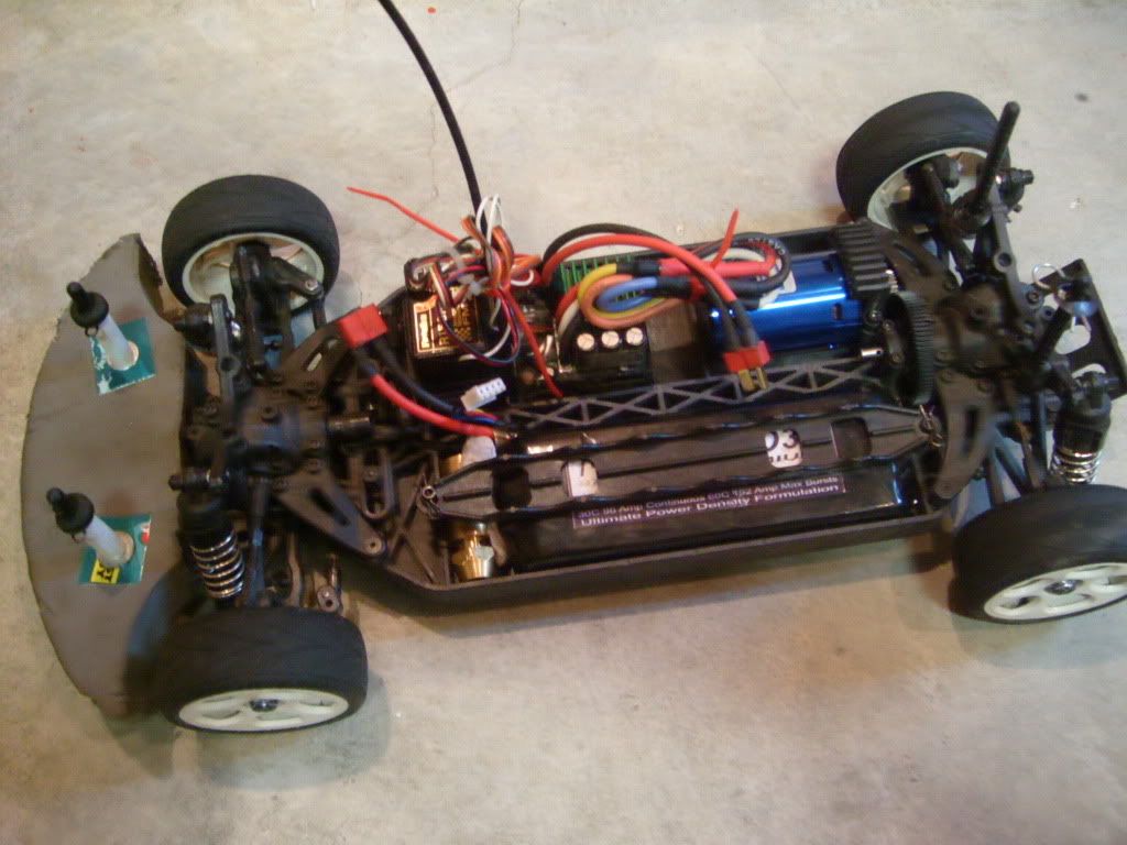

FINALLY pic. Has the flightpower evo30 3200mah 3s lipo, quark 4t motor, MM, and an external bec in there. Note missing driveshaft.

Looking good....few things:
- You need stiffer springs
- Sway bars (rear for sure)
- Definately foam tires!!
That should help you keep a handle on the car. By the way, what body are you planning to run??
  (#72)
07.04.2009, 01:36 PM
Clean your RX wiring-
Also your tires are on backwards.
Thanks. I'll put those on my list. I'm running the mazda body on the previous page unless you guys can find me a really aero body.
Thanks Ian!

07.04.2009, 02:36 PM
I like your motor wiring.

Yeahppp I got lucky on that...
