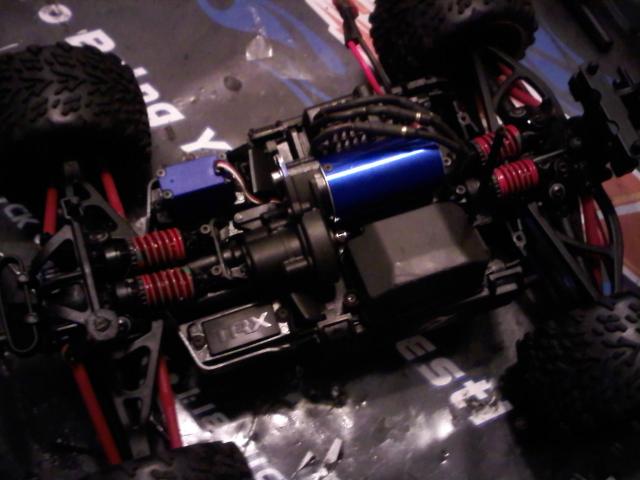

Here is my Mini Revo Blacked out, Dyed the chassis and rockers, Then I sprayed the motor mount, Added some black heat shrink here and there, Then I installed a Mamba micro pro, I hated how the stock one had no settings and breaks where horrible, It runs about the same temperature as the stock VXL Around 140 on 3s with 23/50 gearing and the motor runs a bit behind it at 130ish while the lipos (3s 3200mah) Run 80 degrees. I like how I can run the punch control at like 70% and not have to worry about snapping the Driveshafts off the U-joints are going through diffs ( been there done that already)

I have a Hitec 85mg I need to steal from my Mini-t just need to get a new case for it since I cut the tabs to fit in it. I am going to check out the lunsfords, Also going to find some black shock socks and then change the Positive wire on the micro pro to a black wire, then I should be set.
