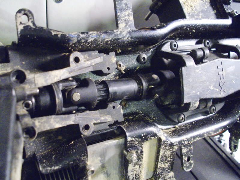

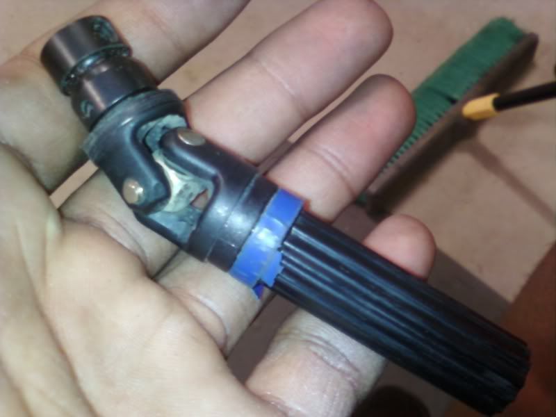

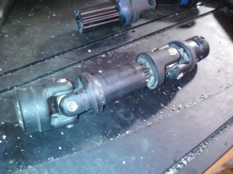

Well in lieu of my failed center drive shaft couplers I had to come up with something stronger.. while rummaging through the spare parts and such i had- i found that the coupler to the standard LST center cvd looks very close to fitting with the tapered u-joint of the revo wheel drive shafts.... I had one of those "this just might work" moments...
The revo shafts had to be ground down slightly, easily done with a dremel- to fit inside the Lst coupler. once the fitting was done i squeezed the whole thing together in the vice so that it was a tight fit... then it was as easy as putting a pin through the entire assembly and setting it in CA-viola! Then you need to swap your modded u-joint over to the center axles and trim them about 3/16in to fit in the stock location. after about 2 hours of racing they are still holding up

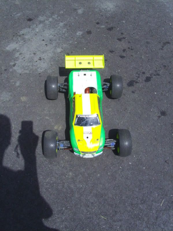

Got my wheels and tires in, they are great- it was almost like they were pre-balanced!.
Also got my losi wing installed- bask in the shiny-ness because after sunday it will never be the same

Looks like a sprite can. All jokes aside, it looks great Ben. Nice work.
  (#53)
brushlessboy16
brushlessboy16's Avatar
07.18.2009, 07:27 PM
I was going for mountain dew but sprite works..
thanks ian. takin her to the track tommorow :)
Mini-update. had a problem since i had the truck. off Every jump the truck would nose dive horribly, i went with heavier springs to compensate for the weight of the truck.. ajd now have 70w oil in the shocks with #3 variable dampening pistons.. now the truck is more stable on flat ground.... I was about to jump it when my battery packs hit cuttoff.. Was this a move in the right direction?
