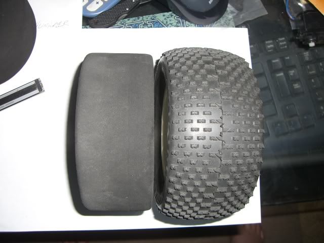

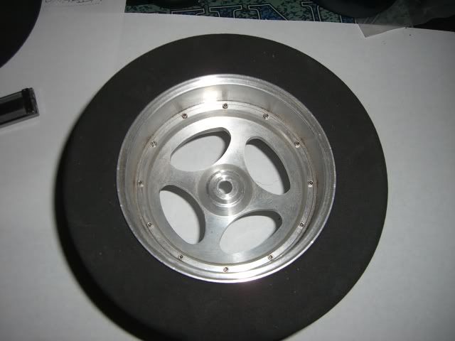

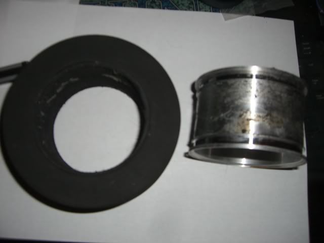

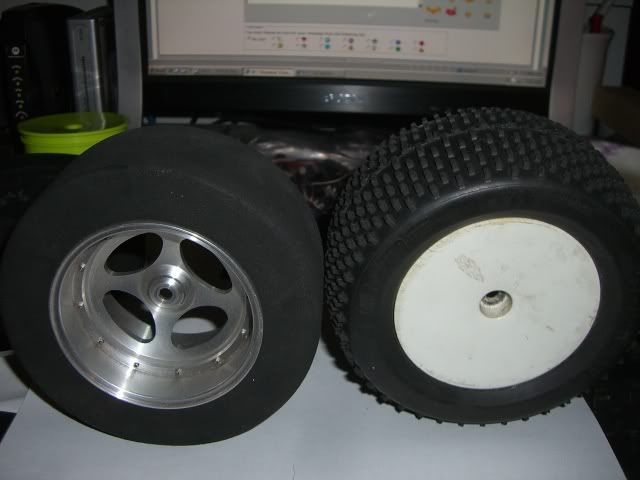

Here some pics of the 5.100 tires I have. Whoever mounted them used the wrong glue so I am going to dismount them and try to glue them on plastic wheels with good ca glue.The biggest issue being the foam is to thick and heavy so when I am going 75+ will the centrifical force throw the donut off the wheels.
Donut that came off the wheel on the first run.
Next to a proline mtr about .500" difference in diameter.
