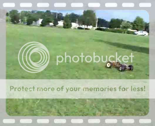

Well the vids didn't turn out as well as I thought they would. I swear we missed some of the best stuff. Its mostly me turning at high speed. Oh and I forgot my body clips, I had enough faith that even if I did flip the truck could take it without the body. I know, blah blah #1 rule of RC: never run with the body off... lol You can see in one of the clips that I do roll it but no harm is done. (Those FLM towers I got from Mark are tough as nails!) All of the swerving/wagging is on purpose. Enjoy.
Bottoming out aside, I think its tuned very well.
