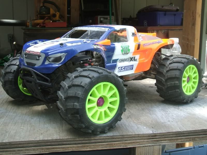

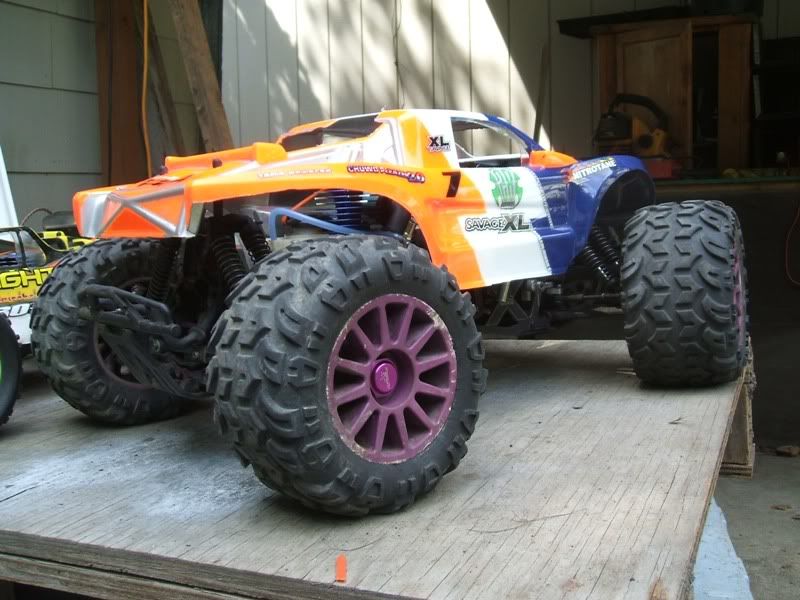

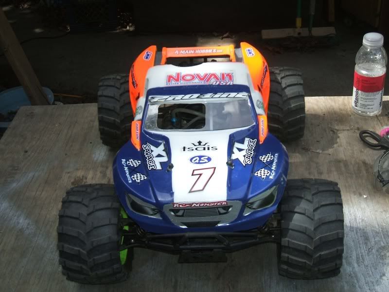

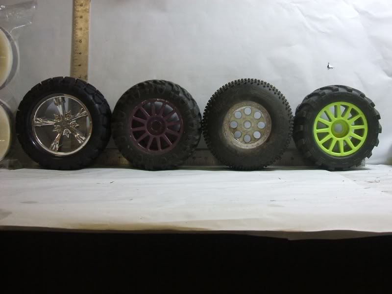

I'm a masher fan as far as a all purpose/season tire. I got some MT badlands but they just don't seem to fit the size of the Savage (too small for my taste) but they are some good tires also. The Moabs are real decent, traction isn't as good as the mashers, but on mine the sidewalls are a bit stiffer and they seem to wear real well. The mashers are the smallest in height for the tires I have tried and make the Savage XL a bit easier to handle on the high speed runs. The mashers and moabs needs some good tape to keep the ballooning down on them. The moabs rubber seems a bit thicker which makes the foams that came with them sufficent. The mashers foam is decent enough to get the job done for a decent length of time but some xtra firm foam inserts might be something to consider with the 40s mashers. The Hot Bodies came preglued and could of really uses a more solid foam base in them. They do real well on road but off road forget about it, especially if you loose your front drive line. Sucker just spins in circles even with an extremly light finger. You know about the Terapins, real fun to bash with but an elephant on stilts anytime else. Thinking long term the get the best tape your money will buy for taping. Moabs seem to wear the best, then the mashers, and badland do well but they wear faster then the others if you do a lot of onroad driving. I like the 23mm hubs on the savage xl. I couldn't find any decent 17mm hexes for the XL and the 23mm lets me crank them down tight.
Here's some pictures for a comparison on size of them.
From left to right:
Hot Bodies Quake on Slayer rims, 40s Moabs on 23mm wabash, HPI Terapins, 40s Mashers on 23mm wabash
Mashers
Moabs

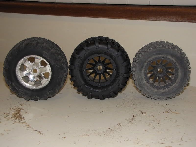

Just ran the stock tires initially. Was fun for a while but the handling was a bit wild and inconsistent with the tires ballooning. Offroad grip wasn't great.
After reading some forums i went to the Proline Badlands(MT size) on 17mm 1/2 offset Maximizer beadlocks. These tires have a phenomenal amount of grip offroad. Some of the hill climbs i've done with them have really suprised me. Looks wise the tread pattern suits well but they appear too small on the truck for my taste.

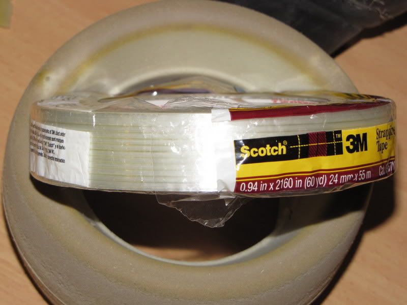

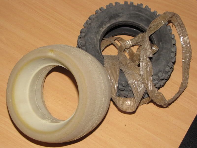

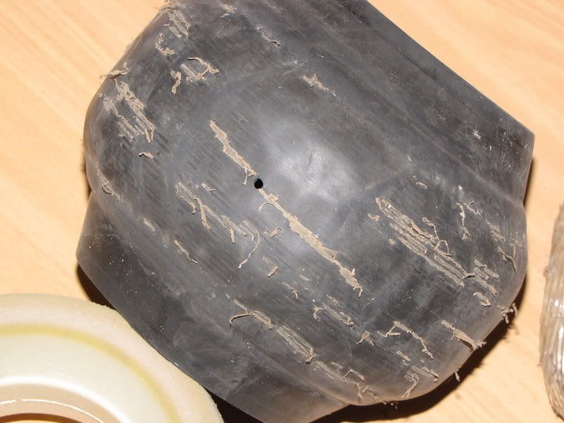

I put 3 1/8 inch holes in each Badlands tire and strapped the inside with Scotch\3M Strapping tape. It lasted for about 6 ~45min runs on gravel\dirt before the rears let go. The outside of the foam was fairly dusty when i opened them up.

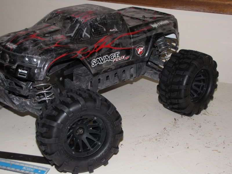

I am about to try HPI GT S tires on the Maximizers. They look awesome. I've ordered the firm HPI foam (4667) for them. The stock foam seems a bit plush. The GT tires aren't as tight a fit as the Badlands, much easier to get on. Hopefully this doesn't mean the bead will pull out easier. I'm going to find some gaffa type tape to try with these in the hope that the dust affects it less. It should be wider too so probably 2 strips instead of 3, less joins for the dust to get into.

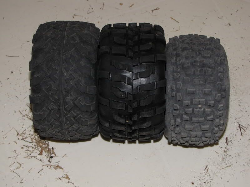

Wheel\tire combo weights:
Stock - 299 gm
Badlands\Maximizer - 325 gm
GT S\Maximizer - 386 gm (bit heavy, if i like the tires i'm thinking i will glue them to some dyed black JConcepts Rulux wheels)
There doesnt seem to be an ideal bashing tyre atm suited to 1/8 scale brushless trucks. I'd like to see something like a larger diameter Badlands (with some sidewall support) with slighter wider tread width that was belted to fit standard MT size wheels. Or may a same profile Badlands but larger inner diameter to suit the larger diameter low profile type wheels (again belted). A harder compond tire would also be interesting to try. Moulded closed cell inner foams would be great too.
Stock Flux, HPI GT S On Maximizer beadlocks, Proline Badlands on Maximizer beadlocks
Smaller diameter and width of the Badlands
Remains of the strapping tape and dusty foam
Remains of tape still stuck to the tire. It appears as though the dust stopped the adhesion working
How the tape looked before
Test fitting the new wheel\tire combo on the truck

I first clean the inside very throughly with rubbing alchohol to get rid of the antiaging powder, otherwise the tape just wont' stick. You can see the crud that comes off in the photo. I also do this to the rubber lining before I glue the tires on to make sure it makes a good bond to the plastic rim. In my case, I also take my dremel and rough up the plastic rim to make sure the CA glue has some extra "grip" to the surface.
I then use straping time and slowly go around each wheel and do a 1" overlap. Sometimes the rubber still has to much rubber "residue" and it wont' stick very well the first time. I usually have to take off the first tape job and then the second one sticks on much better. Softer tire compound wont' make the tape stick as as well as harder rubber compound, it also depends on what type of tape your using. Some guys use duct taper, others have used Gorilla tape. And no, you'll NEVER get the tape perfectly even and straight, just not gonna happen on a ovalong and curved surface :P
I also highly suggest using wider tape as the more wraps you do with smaller tape, the more likely it will come off.
