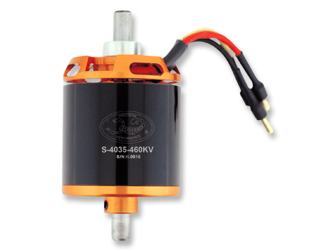

This is the model I am going purchased to design it around. Quite powerful, but only one of a couple that will work.
http://www.innov8tivedesigns.com/pro...roducts_id=539

Awh, no HK series? Those things, judging by the numbers, seem like they should be real powerhouses. Too bad the kv is so high...
My guess would be that you are planning on using the motor to replace a diff, and are planning on using some sort of planetary reduction. At least say if I am close?

You're close.

My guess would also be on replacement of a diff. Other things that come to mind are mating a ring gear on the shaft, and attaching the motor to the bulkhead. Or replacing the standard shaft with a nitro engine crankshaft turned down, for attaching a clutch.
