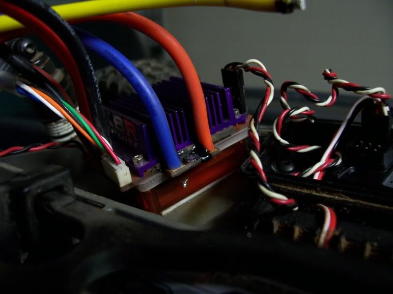

This is the result. Nowhere else on or in the esc was affected, just the motor wires. When the same thing happened to the havoc esc though, it was the power wires that melted off, not the motor wires. I really hope this esc can be saved, that is just a resolder of the motor wires. We live in australia & by everything in usa cause its cheaper, & we have our last race meeting coming up this sunday.

So, two totally different systems, even motors? A radio wouldn't cause that since it sends low power signals to the ESC. At most, a faulty radio would simply not work, or send the wrong signal.
I assume you checked the usual things: How do you have the gearing? Is there any driveline binding?
The batteries could be at fault, but may be hard to tell unless you get an Eagletree in there.
