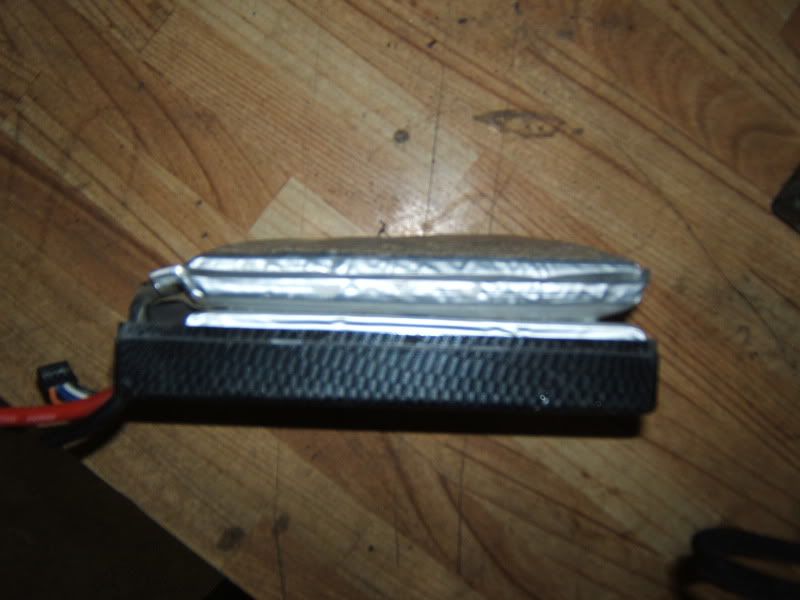

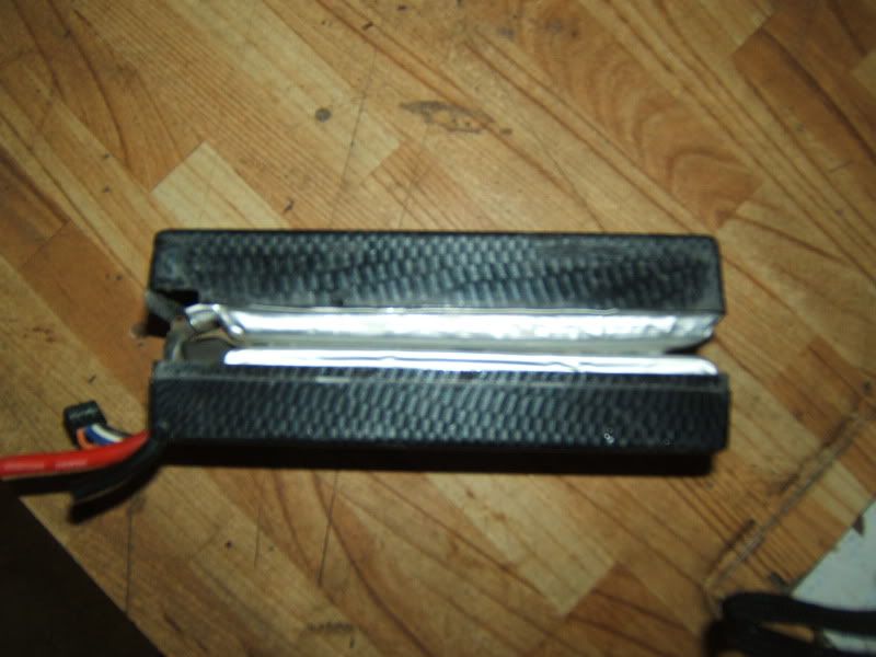

Last night I was bashin the savage in the snow and all of a sudden noticed a SHARP drop in power, stopped immediatly and ran over to it to hear a "pssss" noise..I am now thinking "holy shit, it is going to light on fire" lol. I ran it to the garage cause it was about -20 and saw that the lipo had puffed... I should have known better! My assumption is that water caused the leads to short thus puffing it. Any other educated-guesses?

I noticed even in 50 degree weather my Zippys take a while to get warmed up enough to put out normal power, could you have demanded more than they could give due to the packs temp ??
Hobby City packs have the hyperion tabs, the big plugs.
Sorry for your lose.
12.06.2009, 06:41 PM
Matt..that really suck when a battery puffs. The li-po do need to breath a bit to help release the heat build up....so I would leave them as is.
The turnigy/zippy batts. use JST/Align taps
12.06.2009, 06:44 PM
Water doesn't have enough of a low resistance to short a battery like that. Most likely, they couldn't deliver the required current probably because of the low temps.

I wonder what the min temp for running lipos is. I was running my old TrueRC packs today in the snow, but it was still 35F outside.

That's what sucks about it, they are NICE thunder power lipo's. Hmm, I should have thought about the low temperature...I guess I will have to do some homework on the operating temps of lipo's. And yes, -20C. The other battery seems to be fine, cycling it right now just to make sure then it's going up for sale.

Yep, too cold. You need to look into a heating pad or similar, and also find a way to insulate the batts, I use thin packing foam.
Packs preheated are crazy punchy and shouldn't puff due to low temp because they can't really cool back off as long as they start warm. You can't keep an eye on temps with hardcases and that's why I'd never run them. You really need to know what's going on with them during a run. If you sell them do yourself a huge favor and get noncased packs next time. The cases will do nothing to insulate them, and will contribute to overheating in the warmer months, double bad news.

The thing is, the packs came out of my warm house and then ran for a while so they should have been still warm, THEN it puffed. However it was pretty cold lol. That hardcase saved my ass a couple times when it came scooting out of my slash at mach 3 haha. However you are correct, it's hard to judge temp when they are in a case. Zippy or turnigy it is!
