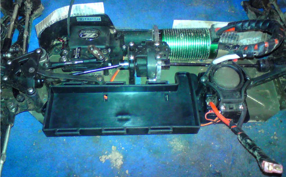

I'm using the Traxxas MMM mount on my 8T and have trapped above the ESC, between it and the mount then I've added a thin disc of air filter foam.
Not as restrictive and just stops any crud dropping into the fan...ESC has been nothing more than barely warm after use on each occasion with it fitted.

01.07.2010, 07:55 PM
What you did is a much better solution and still allows good airflow around the heatsink. Plus it probably cost you less than buying the pantyhose wrap off some website.
01.07.2010, 10:00 PM
Amen to that- I want/need to do the same on the Gmaxx, get fed up with removing half a ton of dried grass after every run..
