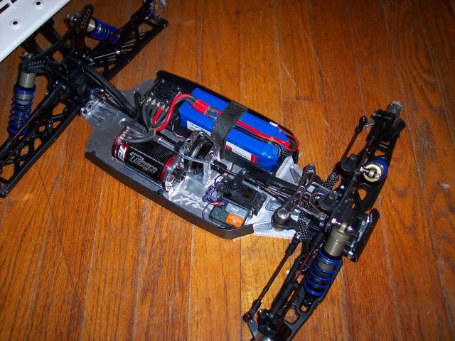

Mike forgot to send my servo tray piece but then he had the idea to see if flipping the servo arm around to so if it would work and it does. so i think he is gonna work on a Rx box to go in the new found space....
Hmm... I looked at the flipped servo saver arm when I originally built mine and it either contacted the steering link plate or was really, really close. Its been a while now though. Gonna have to look at that again.
to make it...
or break it...
I double checked on mine and it won't work either. The 09 has the CF ackerman plate and it's wider than the aluminum one on the older XT8 so it would hit sooner. Also I have the aluminum hubs that I dremeled a little to get more steering throw so that's not helping.
to make it...
or break it...
i havent dremeled these hubs for more throw yet.... they are off an xb8 buggy i have. but if i did dremel them for more toe i could swap back to the older aluminum steering link and gain another 3-4mm of clearance for more throw.....
im not sure what exactly is hitting the steering link on yalls trucks either the plastic ball cups or the servo saver but i put i just put a shim under the servo saver to just barely lower the ball link and now when it goes full lock if it kept going the steering lnk would go inbetween the ball cup and the servo saver all the way to the ball studs post... so thats another 4mm of clearance
