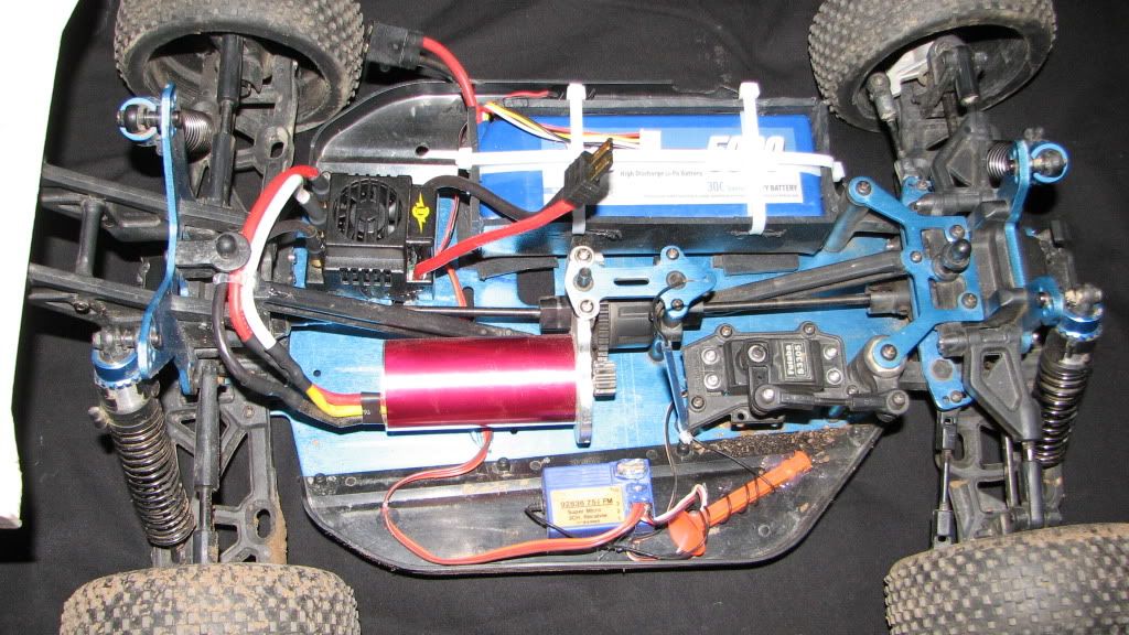

SO I finished it the other day, ran like a bat out of hell. I have some bald tires I use for concrete, turns out this thing has a little too much power, or the Raze was cheap for a reason... Like I said above I am not too worried about the life of this buggy so... Live and learn. I already ordered the upgraded steel helical diff rings and pinions for this and the rear diff, figured I would do both since this will most likely just reoccur in the rear next time I fire her up. Pretty fun though, geared pretty lightly and she screams on a straight with 4s. I like the set up, runs cool, and I haven't even added the motor heatsink/fan that was included yet.
Pics:
And the shredded diff and pinion:

Good carnage ! Same thing happend to me after I bought a used mbx-5T. Forgot to check the diffs for propper shimming...shame on me..stock diffs were fine for nitro, but then I go ahead and add a 5s 2200kv ccneu powerplant and they stood no chance.

is that sand or metal shavings in the diff cases??? you might want to pick up some RTV and seal those up as well

I thought I had it shimmed pretty well but apparently something still gave.
Those are definitely metal shavings. Haven't been in any sand yet. All the grease you see is marine grease. I placed it around the bearings and diff ring/pinion to prevent sand and water entering.
I heard somewhere that these rings might be cast aluminum they seem pretty hard though but that might have been part of the problem.
I have also read that the Duratrax Raze is almost a clone of the Ofna hyper 7 so perhaps I have access to some stronger parts with the Ofna line if needed.

Your were probably reading my thread. :)
the raze diffs are pot metal- go with the hyper 7 gears and you wont have to worry about it.

I went with this:
http://www3.towerhobbies.com/cgi-bin...?&I=LXMKJ5&P=7
http://www3.towerhobbies.com/cgi-bin...?&I=LXMKJ4&P=7
Do you still have that outrunner raze?
