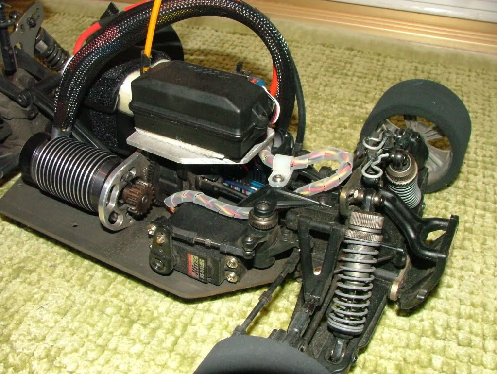

My second Hitec HS-225MG (66oz-in & 0.11s @ 6v) gave out today for no apparent reason. Voltage is present at the servo board, but no go - even with the gears unattached. The motor spins if I apply voltage directly to the terminals, so the driver board is toast. Normally, I'd just get a replacement servo board, but seeing as how this is the second servo that went bad with not much use, I would rather just get another one.
This is on the stock non-extended chassis, so it needs to be a mini servo. After research, my choices are:
Hitec HS-5245MG. 76oz-in & 0.12s @ 6v. About $46
Futaba S9650 63oz-in & 0.11s @ 6v. About $58
Obviously, the Hitec is a little more powerful, but a tad slower. But I am tending to lean toward the Futaba simply because Hitec has been giving me grief. Plus, the Futaba case is a tad larger (still fits though) which means things probably aren't quite so cramped inside and may be a little more reliable.
Any thoughts? Or, is there another alternative?

And how do you propose I fit that in there? It has to fit on a stock CRT.5 chassis, and I have no intention (or desire) for an extended chassis.

Brian your running the original CRT.5 chassis? I got the OFNA extended chassis just so I could use a full size servo (Hitec 645MG). I have also used a Spektrum Z590 servo, just put the hitec in there because it is a better servo and I had it, both threw the tires around with ease. The extended chassis isn't much bigger, just enough to use a real servo.
02.09.2010, 12:08 AM
Yup, the original chassis. I realize the servo choices would be far more open if I just get the longer chassis, but I really like the way it is now. If it gets much bigger, it'll be 10th scale. If I wanted 10th scale, I'd get 10th scale, but I wanted 12th scale.

Which hitec servo are you running? Like I said, I'm kinda leary about them, but maybe the newer 5245MG is better/more reliable than the older 225MG's I had.
I just looked at the JR site and the only digital mini seems a little low on the torque (51oz-in @ 6v), but the 0.06s speed is nice (although I probably wouldn't notice the difference between 0.12s and 0.9s in reality).

The ofna ext is only a fraction longer. If you mounted the servo vertically could you get a full size servo?

Mine is not that much longer. Just enough for the full size servo.

Nitro: Don't know exactly how much torque is required, but the 66oz-in that the 225MG provided was perfect, so I was shooting for around that same value. Anything in that vicinity would probably work though.
I tried all kinds of mounting positions, even some that were never done before. A full size servo is just too big. Even if I cut the ears off and come up with another mounting scheme, there is just too little room.

So your chassis is that much shorter than mine?

If I lay a standard size servo down right up against the steering bellcrank, and cut the servo mounting ears off, I have about 1mm between it and the pinion. Not to mention I'd have to really contort the servo wire so it doesn't touch the diff/pinion.
Thats a big difference! Snell looks to have a good 1-2cm between servo and pinion.

Crap, that's a big difference then.
