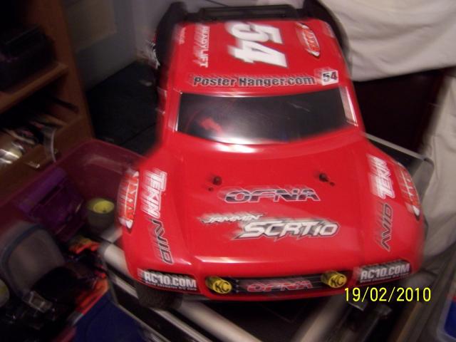

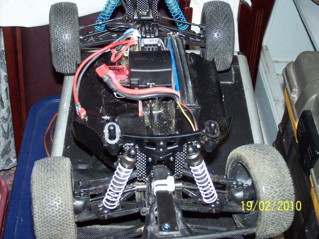

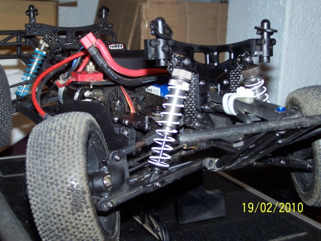

here's a few pics of mine with the new towers and shock mod. Raced it this saturday and it drove really well!

KingSkid, I love my extended towers. You know if you are a really good driver that can stick every landing and can hit the perfect line lap after lap maybe you don't need the tower. But for a normal human being like me I need all the help I can get. I can go off a jump a little out of shape and when I land the truck just sucks it up and stays on the line.
