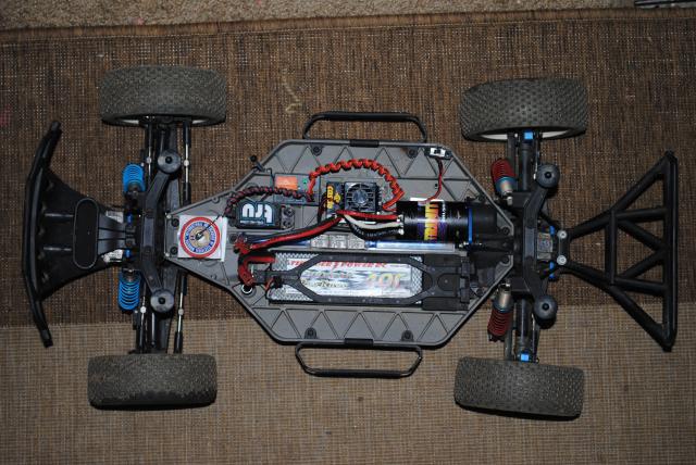

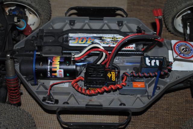

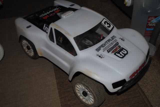

been running two of these setups one w/ 8th scale tires one without clubracing at local tracks with my friend. must say this motor is way better than the hv line. mostly because it has the same ~3mm shaft which maes it a drop in replacement. i ran a 12.5 in it before this on 3s and it was soft. 540 is too small for 4wsc. the trinity motor is the same 100 bucks as the slovak and has an internal fan. get about 7-8 minutes HARD track time on a 3200 3s 40c tp for med size tracks running the stock 13 pinion and spur in both setups. 8th scale tire truck with the slipper and the other is a platinum w/center diff. temps are about 150 on the motor and around 110 on the batt and esc. dont know how fas it goes but it runs down anything we have been on the track with so far. will say that the mmp is 50% of the trucks working so good. it really is an amazing controller with some interesting features... running sensored only mode w/ no cheat mode low timing auto lipo at 3.1 100% brake
