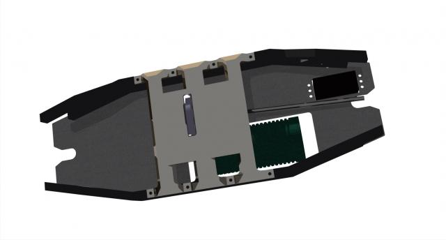

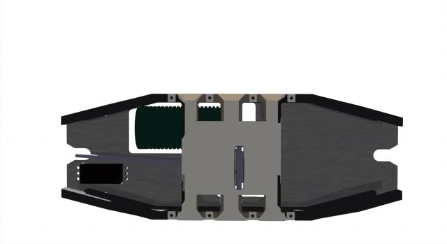

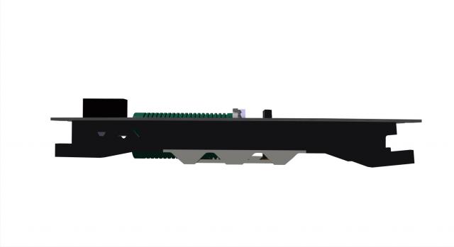

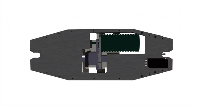

Finally a bit of an update on the design. I decided to try a drop down center plate, and reversed the center diff and motor to get more of the cg to the front. Had to mock up the servo and front shaft to make sure there was clearance. Looks dooable right now. The drop is only a 1/2 inch - could go a little more. My original idea was to get it low enough that nothing was sticking up through the top - but that now seems to be a far fetched idea. I used the muggy center diff set up (1.806" tall).
