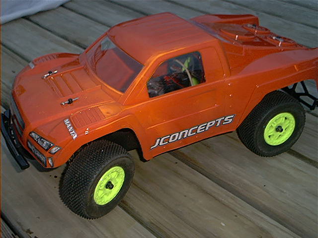

Your right! way to wide for even my widest body,the JC Manta 0 offset is definitly the way to fly I just set the stock body on the truck with those wheels and tires,never really checked SC bodies for widthWith these wheels on the truck,it's as wide as it is long

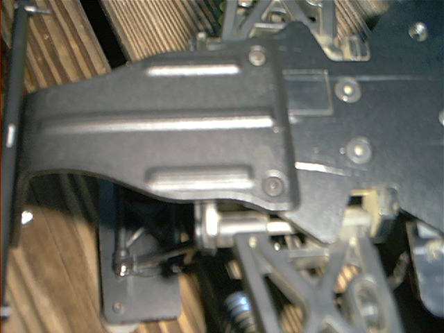

I used the Slash 4x4 bumper because the two front screws matched perfect,I removed the stock bumper and added longer screws. Still might drill and tap two more screws to make it bulletproof.....

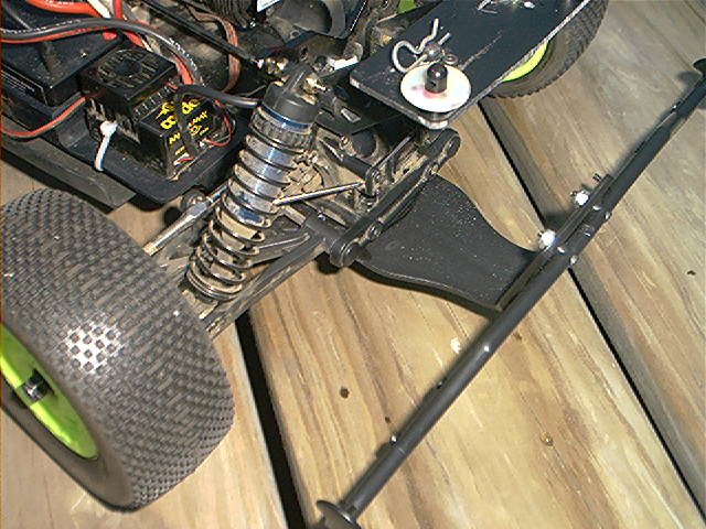

Here is the Slash RPM 4x4 Rear bumper and the Aarms flipfloped!
