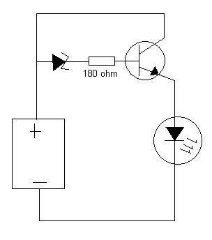

What about a Zener diode on the base of a transistor? I found 3V and 3.3V diodes on eBay, there doesn't seem to be any values in between those.

I forgot I drew this earlier... I'll bet my diode polarity is backwards, too. W/e
The 180 ohm resistor limits the base current to 20mA, which is fine for most small transistors. When the voltage is above that of the Zener diode's rating, the circuit is on. The diode stops passing current when the voltage drops too low, and the circuit shuts off. Just need to find a suitable NPN (could be PNP as well with reversed batt. polarity) transistor to handle the current.

Getcha one of these James.
http://www.all-battery.com/protectio...it-pcb1sr.aspx
Cheap, premade. Should fill the order quite nicely.

Now looking at the specs it appears that the battery + and - are soldered to the B+ and B- and the load is soldered to the P+ and P-... An I correct?

Yes, B's are the Battery and the P's are the load/charger. You charge through this circuit also.
