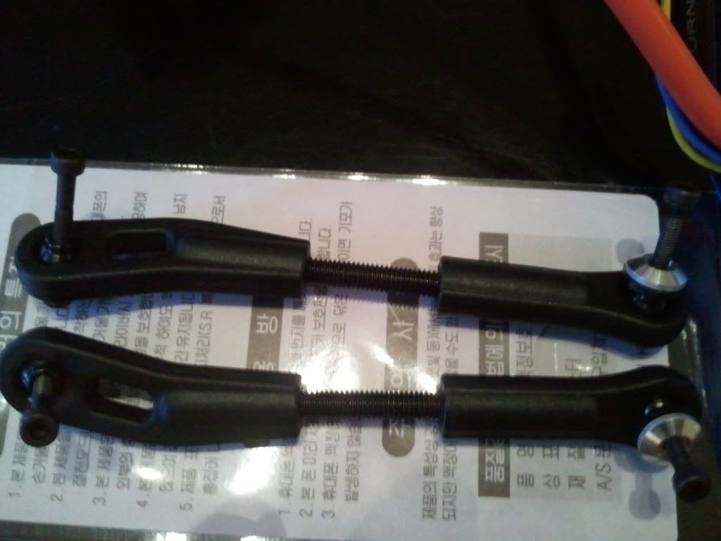

I have been having problems with my steering failing after large cartwheels etc... The stock HPI Savage tie rod ends are just not strong enough!
I even used alloy ends and you wont believe, but after a cartwheel i inspected the alloy rod end only to find the ball stud had been ripped out from the alloy!!!!!
So this is my new approach... i am also hoping in increases my steering furthur due to the bend as you can see in the pic below.
These are beefy mothers!!!! I cant see them flexing anytime soon! Espeically with my TI Turnbuckles :)

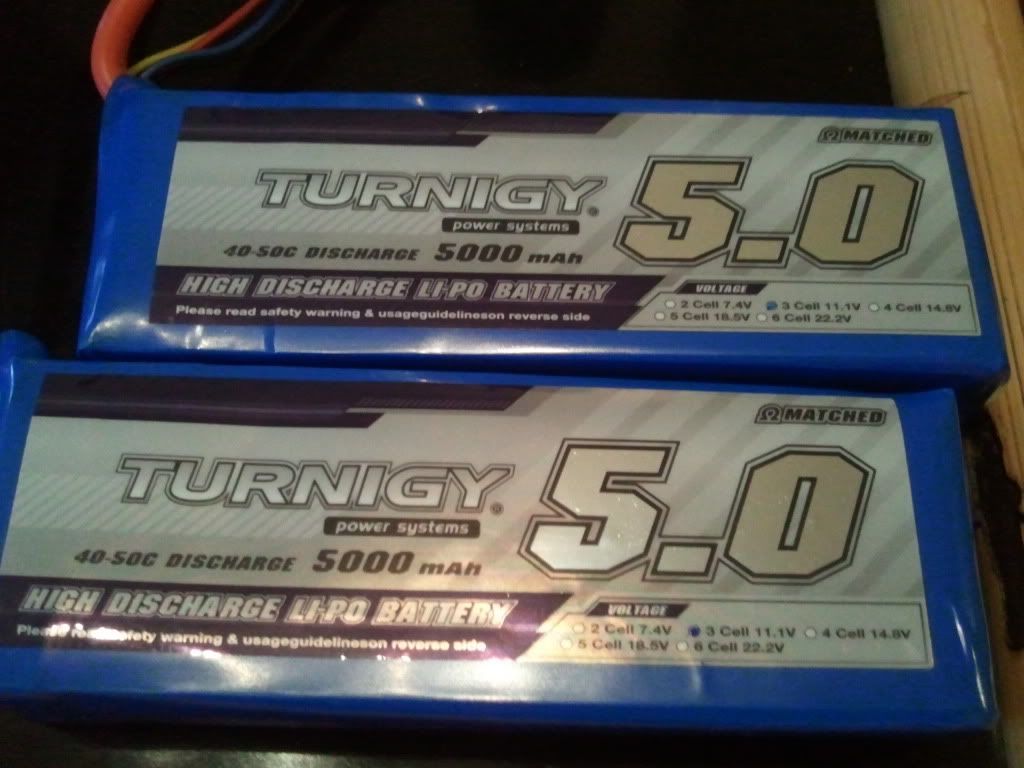

Also my Turnigy lipos arrived from HK! Ordered last tuesday and arrived wednesday after being sent out on friday from the German warehouse... Not too bad!
5000mah 40c 3s Lipos
At least i have some lipos for the time being to keep running

What are those tie rods?
I used Hellfire rod ends for steering in my build. Had to shave things a tad to get full suspension throw but zero issues after some major incidents. Haven't got a good pic of them but they are chunky and look the part.
93627 HPI Turnbuckle M5x60mm Hellfire
85230 HPI Rod End Set 7x45mm Hellfire
86144 HPI Ball 6.8x8x3mm

But i when i saw these i thought they were awesome! They are from a hyper st rear turn buckles
http://cgi.ebay.co.uk/Hobao-Hyper-ST...item255b4068ac
I like the bend in the rod as i have grinded a little too much on my RSC Conversion and its when at full throw... the steering isnt tight, but loose... so hopefully this small bend in the rod end will solve my minor issue and pull my steering inwards a little bit... terrible explanation but ill get pics...

The stock savage rod ends are soft, sloppy POS... IMHO. lol
I used Hellfire rodends as well as thick 5mm buckles from the HF as well.
I'll just post a thumbnail to not junk up your thread:
They are the same rodends that are used on the adj arm kit for the savage also, they they can do double duty for spare parts.
Now str ends are v thick, solid and no slop. V happy results.

Kyosho makes some bent rod ends as well (for the 777 IIRC)
They are for str rods, so they are not as large as the HST rodends as well. May or may not be what you want, and depends on the clearance of your wheels
EDIT: Here they are. they are actually a good mod for the knuckle end of the HST to give the knuckle a bit more clearance and better throw.

thanks for the links and help finn...
I CANT BELIEVE I DIDNT DO THIS SOONER!
this should be a compulsary mod! the stock ends as you say are just plain rubbish.. maybe they would do on lighter rc's but not a heavy savage!

Not sure I understand where you are going with the bent rod ends. They may have helped with the fact that I had to cut off the shock mount on my lower arm as the hellfire rod end would hit them at full lock.

Ok i ran the truck yesterday evening...
Those tie rods are awesome!!!! My steering is back to how it should be! very nice and tight!!! problem is because i ground of too much from the RSC Conversion on the knuckle, and the tie rods are doing such a good job... my drive shaft is popping out on one side occasionally... Nothing an O ring or two cannot fix on the diff side to push the shaft outwards a little...
These rods are not necessary for anyone... i only decided to use them because i ground too much off the knuckle on my RSC Conversion....
upon fitting, you do notice they hit on the hpi sway bars upon turning if you have them that is... But its a simple fix... just slide your sway bar mounts a little furthur inwards and dremel a little bit of the sway bar end to give a little clearance... minor problem really!
The lipos - upon arrival where all equally balanced at 3.87 a cell. They charged up and balanced absolutely fine.
The lipos... i didnt run so hard as i just wanted to break them in... But they gave me an awesome first run time... and held punch nearly all the way till LVC...
I am extremely happy with them! and i dont think i noticed much difference if any difference between these 40/50c lipos and the nanotech 45c/90c lipos i tried recently!!!!!
I will reveiw again as usually the first 10 cycles of these turnigys is where cells can fail or balancing causes problems... but i have already charged them for a second time and they were fine...
When they discharged after the first use... the cells were a little out of balance, but i found that to be a prob on all my lipos... It charged and balanced fine to 4.2V per cell!

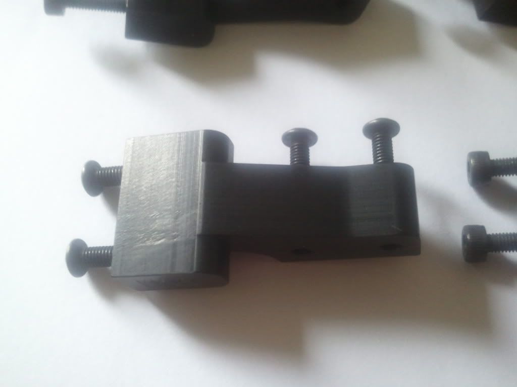

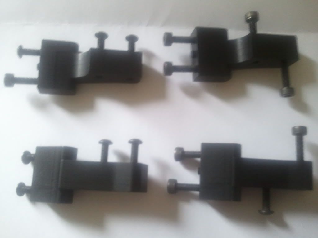

Something nice arrived today from GCM! less than a week from canada to the UK
Hopefully this should cure my lipo mounts breaking when landing big jumps....
