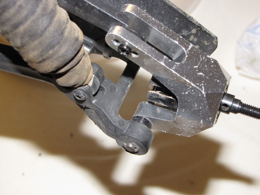

Tried to fit the atomic hubs, but I need a shorter lower hingepin. The stock carriers sit outside the arms, but the atomic (and integy and hpi) hubs sit insde, making the pin too long. They did not come with the correct length pins either... BS.
01.04.2011, 09:50 PM
Did some research, apparently hpi sold a 4x50mm shaft set that secures with e clips on each end. Not available anymore. This is what others have used with the atomic hubs. I could add a screw to the arm to capture the flanged end of the stock hpi pin. And then cut the end off that extends out. I will see if the arms have an area to add a screw.
Looks like the integy parts i got have the pins so i will give them a try with the atomic carriers.

01.05.2011, 11:20 AM
You can get these: (or someone from the UK can post them to you)
http://cgi.ebay.co.uk/HPI-86376-SUSP...-/160506095635
01.05.2011, 12:01 PM
That is them, I will see if the integy ones come with the correct length shafts. If so I will just pirate those!

01.05.2011, 05:26 PM
I have the Integy XL carriers, they came with the correct length shafts for the Flux lower arms.
  (#30)
01.05.2011, 05:30 PM
Good to know, the atomic website shows the carriers with correct length pins in the pics, but both of mine did not come with any in the packets, and no mention of them in the instructions. Oh well.
