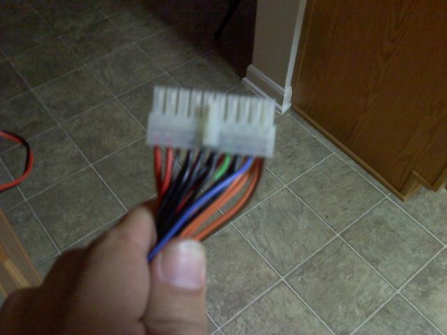

Here are a couple of pics. The only wire connected together is the brown and an orange. (orange is 3.3V right?) all the other wires are each connected to their own terminal. I'll take it apart at work in the morning. Is it normal for the 12V source to be less than 12V?
We use a small switching power supply on one of our controllers and and we have to set the +5 to bring the +/- 24V to be within spec.
Jeff

01.10.2011, 01:55 AM
If hat brown wire is a feedback wire, it's for the 3.3v line, which won't do much for the 12v line unfortunately.
And yes, it's pretty common for the voltages to be a bit under/over their values. IIRC, the ATX spec allows for +/- 5%.
The only thing I could say is to load the 5v line and see what it does, and/or open her up and see if there is a pot in there you can fiddle with.
Oh, and if you do end up loading the 5v line, make sure the power rating of the resistor is at least 4x the power needed because it will get quite hot otherwise. If you do load it with 1A, that means you'll need a 5 ohm resistor rated for 20w (or two 10 ohms in parallel, each rated for 10w).
