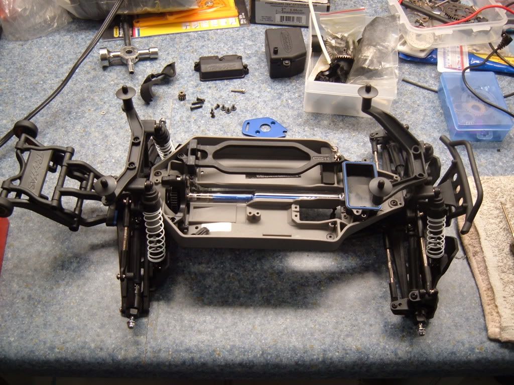

Out the box, with a few parts removed:

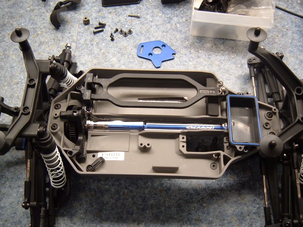

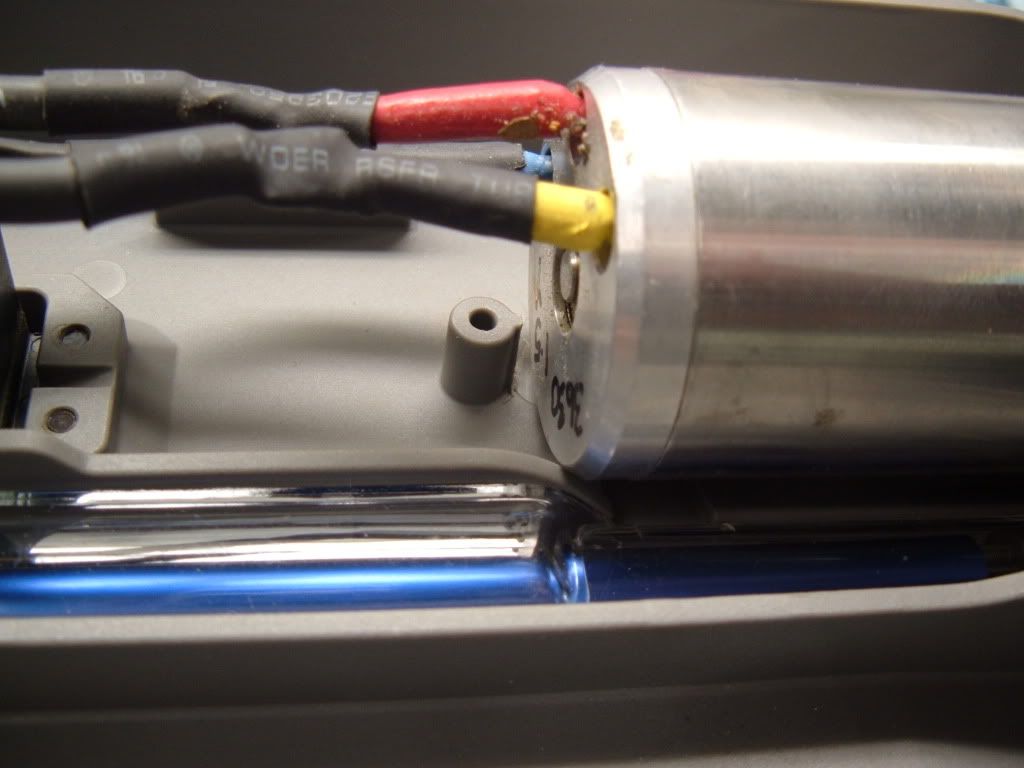

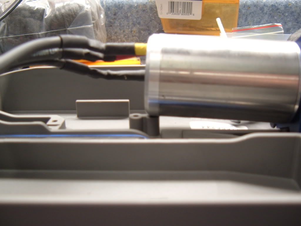

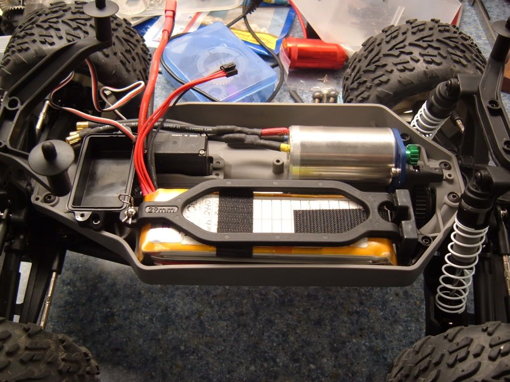

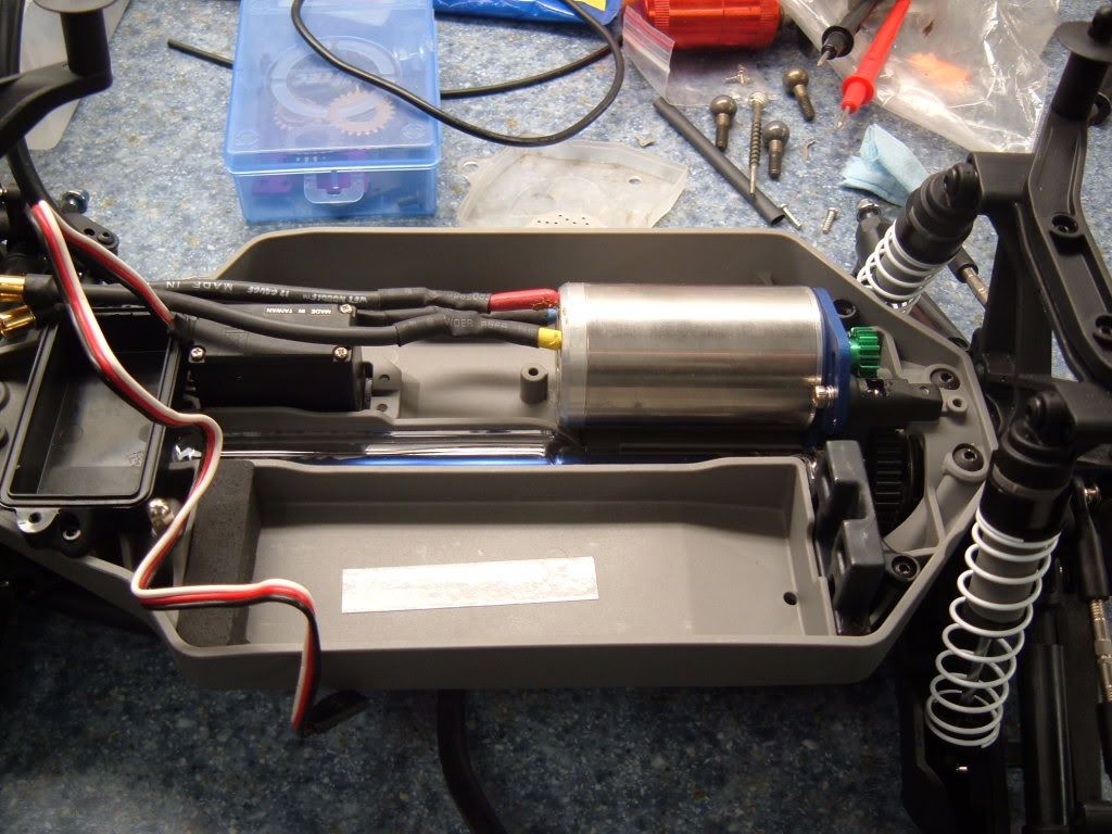

Had to trim on of the esc mounts(?) off to get the longer aveox 36/30/1.5y to fit. It is aboutthe same size as a 1512, for reference. Useing an 18t CC pinion, 5mm bore, with the stock 54t spur. Should do 45mph or so on 4s lipo.
With lipo, 3200 30c fp lipo. Currently a 2s2p, but I will rewire it as a 4s. This truck is not that heavy so it should do ok.
May have to remove the radio bx and replace it with a homemade platform, as there is not much real estate.
01.31.2011, 06:09 PM
Gave it a test run with a 3600mah 4s 12c (!!) lipo, ran great. Only did 10mins as I did not have the lvc set but temps on everything stayed below 100f. Plenty of power, I have the punch control set at 50% and it keeps the backflips to a minimum. I really like this truck, handles well on concrete and blacktop. Did not jump it yet, but did not the front of the truck bottoms out under very hard braking. Might have to add some fuel tubing to the shock shafts to limit up travel a bit.
Will the slash swaybars fit this truck? I may have to add them and see if it makes the hadling any better. It does not really pitch sideways that much, but I am used to MT handling...
Great truck, only issue I can see is that the rear driveshafts will not be lasting too long with the 4s aveox power. I will likely mod a set of rear carriers I have to use the old maxx shafts with the 6mm axles. Until then I will just enjoy bashing it!
