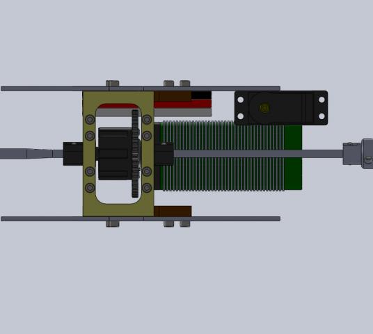

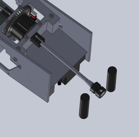

I finally have a few minutes to mess with the project. I decided to pull the CVD's out of my LST2 and what do you know.... They fit!! Well close anyway. The are just a hair too long and bind if they are straight. If I raise the center diff they seem to work nice.
I modeled them up tonight without moving the center diff yet. Here are some pics.

Hey bud, whats the length of the CVD? pin to pin..

I need 93mm. (3.66 in)
The Losi cvd's are 3.835 in.
After working on this last night I don't like it. The diff needs to move way up. I'll look for another dogbone or change things around.

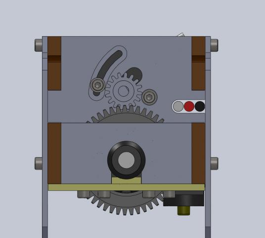

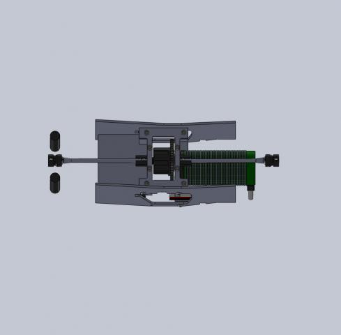

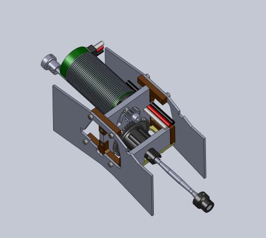

It's been a while since I updated this post so I thought I would share my progress.
I'm working on the second concept now that is a lot stronger and probably over-kill but that's what makes it fun. My Kershaw tranny would constantly bend hardware from the weight of the motor & tranny.
I changed the hardware from 4-40 to 6-32 screws and all parts are machined from 1/4" 6061-T6 stock. It won't be light but hopefully less than my last 14.8pound Flux. The motor mount changed from vertical slots to a pivot. Easier to mesh and less chance of slipping.
Did I mention the motor also flipped 180 deg and is now in the front of the truck above the servo? The shorter universal will be in the rear where most of the torque is applied. More weight balance to help with traction as well.
