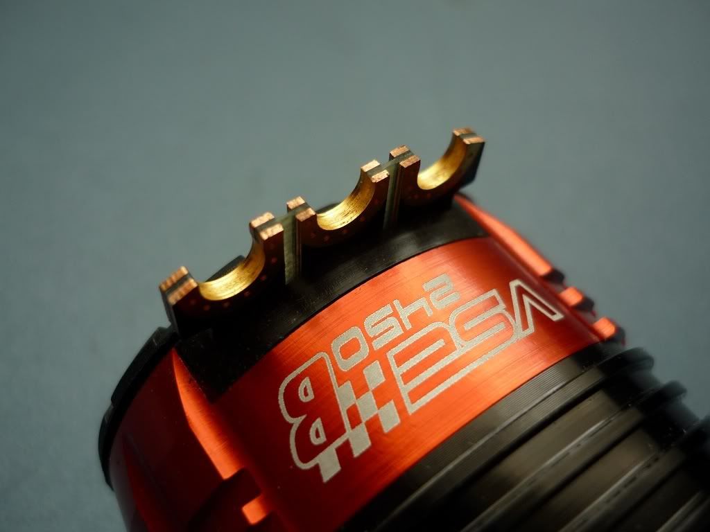

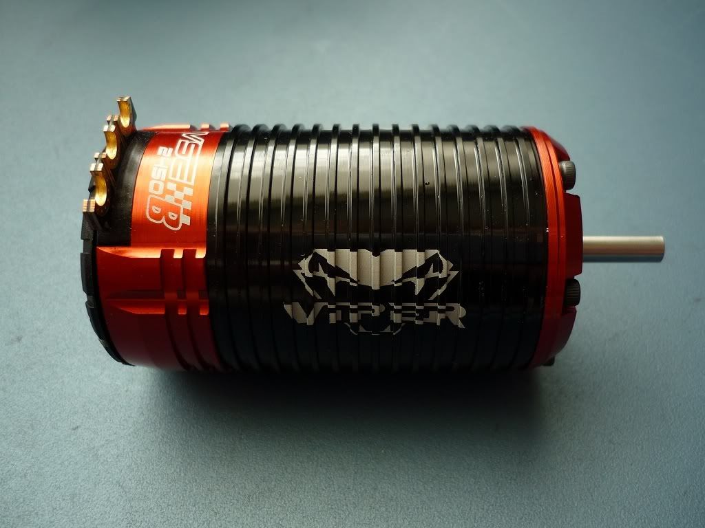

Got my Viper motor today. Looks pretty good, solder tabs have plenty of copper. Going to visit a friend this weekend, but should be able to test it out next week.

Looks Very Nice Indeed :) - 07.21.2011, 10:08 PM
I really like the look of this motor, every detail. Great Pictures :)

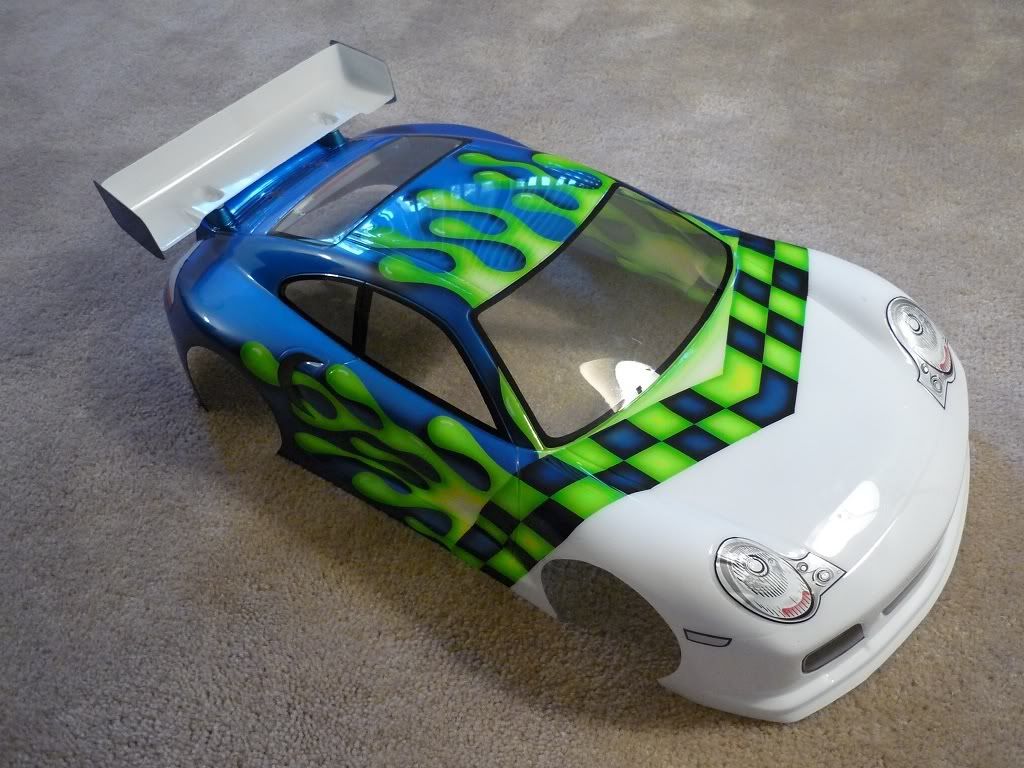

Here's the body I picked up awhile back, Ofna Porsche 911

Nice paint on the Porsche Champ.
