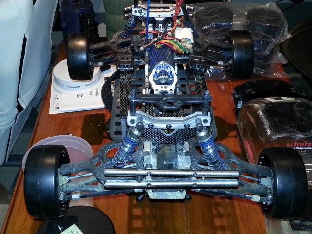

I ended up getting HPI 17mm Hex which use the same size pin I already had (2.5 X 12) and a set of Sweep belted tires already mounted on black wheels. Not as nice looking as the aluminum ones but they feel really solid. I doubt the would balloon at all.
Given the smaller radius, the new theoretical speed is now 71 MPH. Let's see how hot the Schulze gets before I hit 50mph

Yes, I saw those as well but I have to say, just got back from trying out the Sweep Slick 55 and I had a blast. No ESC overheating, a good degree of drifting until they warmed up a bit, much easier to drive.
Meanwhile I lost a wheel because the nuts are not right and the nylon part does not reach so they come loose easily. I'm waiting for the HPI nuts and hopefully they'll work better otherwise I'll need different CVDs.

You can spin those nuts and put the nylon part on first. If it's a flanged nut just use a washer for the flange. Also, loctite is your friend
agw
11.30.2012, 12:14 AM
Not a bad idea at all but it turns out that the flanged nuts I was using were just too big. I switched to the same M5 I had before and put a little washer instead. Now I have no problem...well not that problem anyway...
