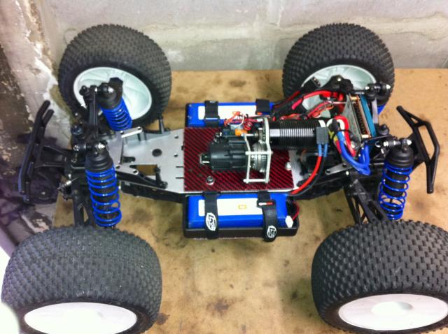

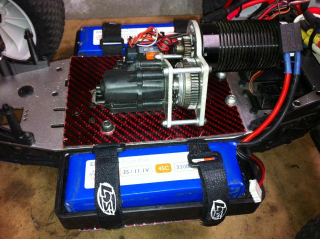

The mount is the Kershaw Desings for a Summit running the CC1520 it raises the motor enough to clear the shock mounts on the Summit and the slipper is a RRP slipper set up for a slash 4x4. I may convert back to the stock motor mount to lower the motor or just use my 1717
Relocated the batteries
wellby
wellby's Avatar
Posts: 78
Join Date: Jan 2012
Location: Queens NY

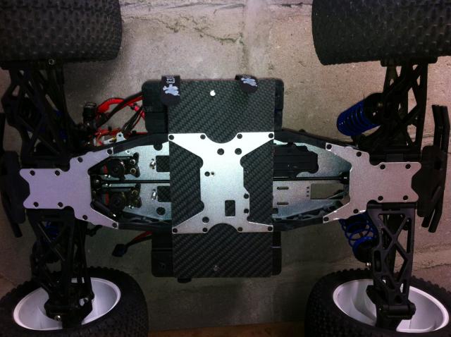

Relocated the batteries - 03.23.2013, 09:02 PM
Moved the batteries to the sides, made a simple tray that is mounted between the frame and lower skid plate and mounter 2 rc monster universal battery trays
to lower the CG a little. Going to try and get some videos
