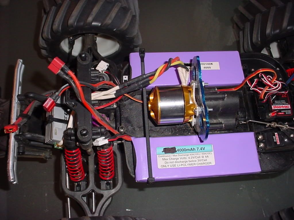

08.15.2010, 06:20 PM
Before the Direct Drive to Diff Revo, was this E maxx.
It's outrunner motor was attached straight to the Tranny.
It ran like:
The e maxx motor was a TowerPro 3520 660kv motor. It performed well.

I still have my emaxx. I like what sikeston34m did on his old emaxx.(post #8) This looks to be a better option than an outrunner by itself. It looks as though you mounted the motor where the spur gear shaft was? I was looking at doing the same thing with mine. I have the newer e maxx(3905). The overall gear ratio would be 5.22. I'm using stock diameter tires. System voltage is 13.2( 4s A123). I can go 6s if needed. I was looking at using a Rimfire .46(800kv). If I mount the motor to the front of the trans. will it upset the front to rear balance to much? It looks as if I can flip the trans 180 degrees if necessary. Thanks, Don
