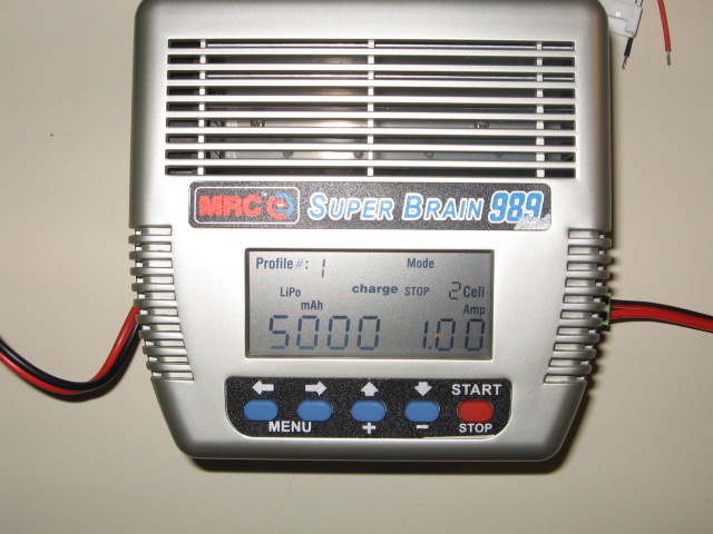

mrc 989 and hyperion lba10 - 03.22.2007, 11:21 PM
i searched for a while and could fine the info i was looking for so here it is
#1)is this hoodked up right for charging with the balancer
#2)is it set up properly to charge 2s lipo with 5ah packs, besides not having a plug for pack,
#3)is the amp setting right
just a few to get this thread going, ill post all questions about this combo and any charging ? i have in the future

1. It appears to be setup correctly
2. Same as above
3. The amperage should be 1C which for a 5000mah pack, would be 5 amps, not 1 amp. That is only .2C

ok , thanks alot just new to this electric, so im trying to learn as much as possible, dont want to ruin the batterys, and i didnt get much out of the instructions that mrc provides, thanks again
