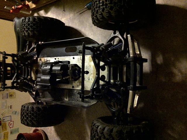

So pics below of where I am now. I could probably steal the ESC and Receiver from my E-Revo but I'm saving to get another setup. Not quite sure if I want to sell the E-Revo yet. I'm excited, I'm curious how the truck does with the 1518 motor in there, i'm looking for some gut-wrenching torque and I think this will provide it!
