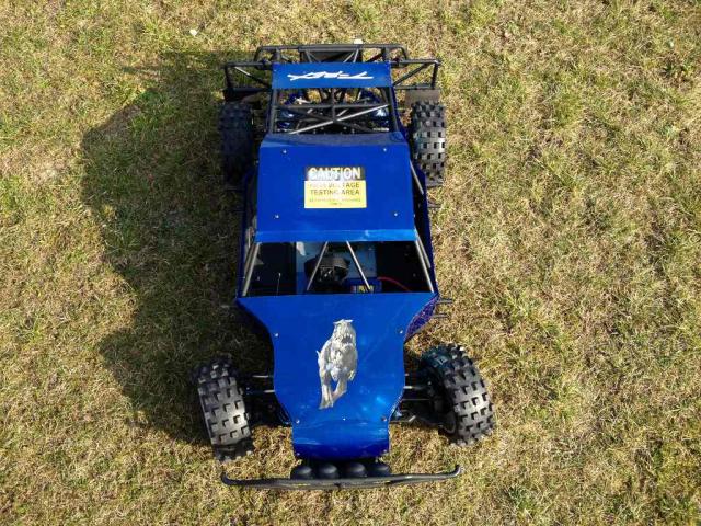

After having driven a Carson Dirt attack XXL (same chassis as a Rampage XBE) for almost a year i decided to take the next (and likely the last) big step and bought a new Losi 5T roller (without body, tires). I almost pulled the trigger and bought a Losi Desert Buggy XL but given the fact there was no motor mount readily available and that a Losi 5T could simply be given the look of a buggy (i am more partial to buggys than trucks) with some easy to fab lexan body panels i decided against it ... luckily i have talked to a fellow rc buddy which convinced me at last to go for the 5T (his opinion: this is the only rc car which looks like the real deal while driving over bumps).

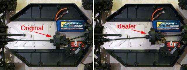

As this worked out like planed, i ordered a Castle 2028 motor and an rcmonster motor mount. I suppose after having watched the last picture you can make out one big issue the original placement of the center diff poses. I was told that due to the rather extreme angle of the front center cvd the front outdrive of the center diff and the pin of the cvd wears out rather quick especialy when using a powerful brushless system.
