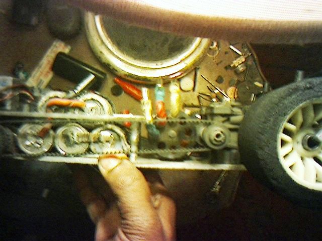

I have since changed the car over to 5s1p, but you can imagine what I was talking about. Sorry about the cell phone pics.
