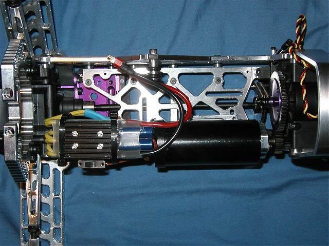

01.27.2008, 04:14 PM
OK, finally got a good fit in the original ESC plate position. Used 5.5mm connectors and ran the wires under the plate. Everything is secure and its not as tight a fit as it looks. There is plenty of room between the caps and the motor (about 2 rch). Going to run the whole thing this evening and see how it goes. Oh, the padding under the ESC heatsink is some thermal CPU tape.

BashOn
01.27.2008, 08:53 PM
It looks really good. I'm uploading pictures of my build now. I wont be able to run mine yet because I am waiting on the bullet connectors for the ESC. What do you think about the battery stops? I am concerned that with the packs (we have the same flightpowers) the little black ones will dig into and damage the battery during bashing. They do a good job of holding the battery snug though. I think I am going to make some sort of plate to attach to the forward most battery post to make a solid barrier. Keep us posted on how your run goes.

BashOn
01.28.2008, 11:41 AM
knotted,
I did some searching on thermal CPU tape. I was going to zip tie my heatsink directly to the mount because I liked the idea of the aluminum acting as a heatsink. Does this thermal CPU tape melt to the ESC? It sounds like a great idea allowing good heat transfer, better mounting and maybe a little cushion.
Please let me know how that works out.
knotted
01.28.2008, 12:18 PM
You probably don't need the tape, but it just bothers me to put the ESC on with no padding. I figured if some padding is used it might as well transfer heat. There is almost no melting of the tape, the MGM never really gets hot enough. The heat sink fins just settle down into the tape a little bit and then stop. This helps keep the ESC in place a bit more securely. I have been using it this way on all my setups for about a year now and it works well.

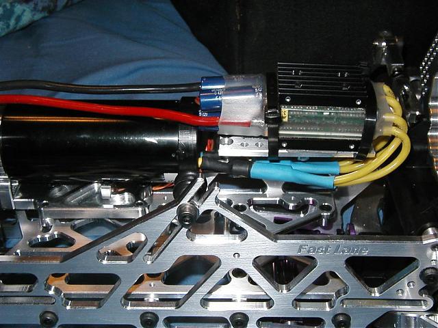

danhfvcsd
08.01.2009, 06:29 AM
Hey man looks great :)
it looks very tight, but you may be able to squeeze that esc inside the tvp like mine - I have screwed it to the tvp with the threaded holes already existing in the heatsink.. Although my esc may be smaller and my motor clearly shorter...
but I have more room in there than you :)
