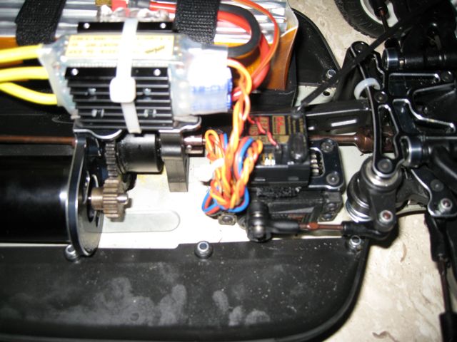

LOL! You're going to need a football field to control it. I just got my Neu 1512 2.5d (2000kv) from Mike and installed it in my XB8EC. Geared at 15/48 on the pinion/spur it is wicked fast running on 4S. I'll probably gear up to 16 or 17 on the pinion after I get some Amp readings during the run to make sure things aren't pulling too hard for the lipo.
I plan on getting a 5S pack when the MMM comes out, but this buggy is plenty of fun on 4S with my limited running space right now.
