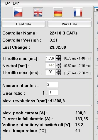

TBH that is the only setting that I'm still having trouble understanding. How hard is you brakes now? Did you set the hardness of the brake separate from the deceleration? I'll try what you did, but I'm lost on that setting and I thought I had the programming done right.
Look at the image above. This is my actual setting.

Look at this funny current values ;)
If my eagletree logger is correct, the max current was 89 A ... (10 samples per second)
300A or 180A is impossible for my old 14cell nimh !
