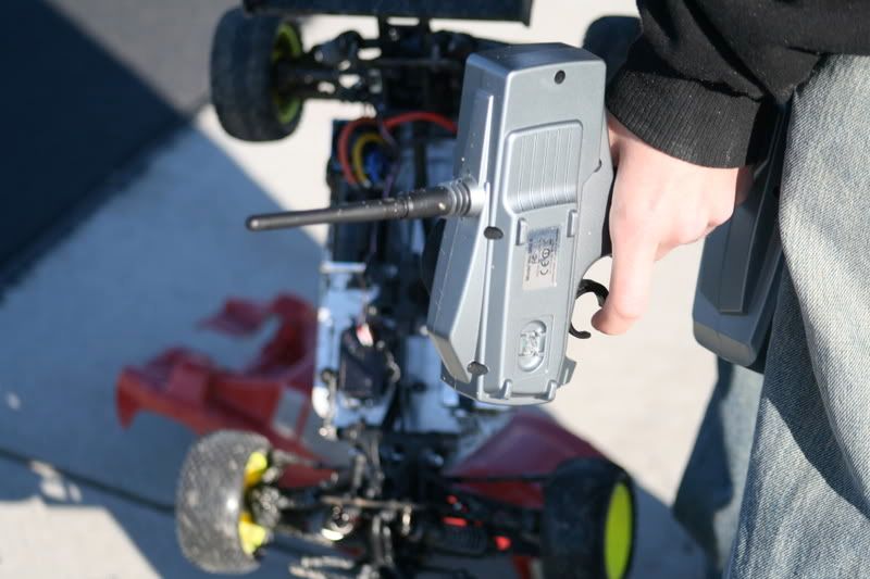

and blacked out revo do you have pics of how you had all your electronics layed out???
BlackedOutREVO
05.11.2008, 09:42 PM
Not really, the ESC was right behind the motor, and other then that, everything else was on the chassis
Heres a OK pic
