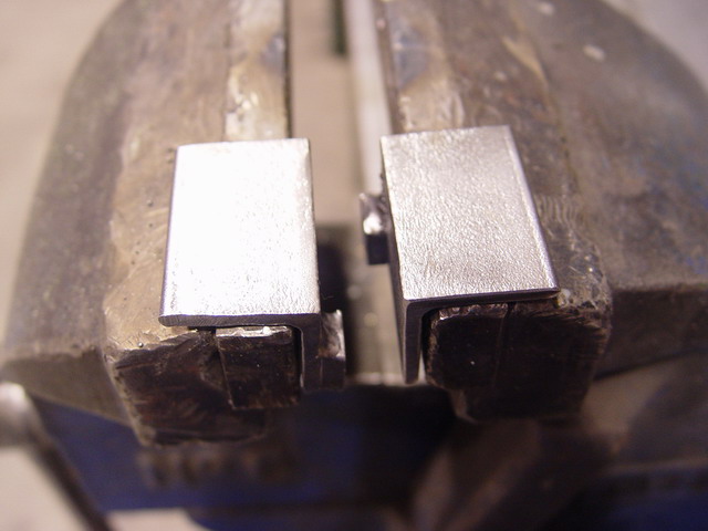

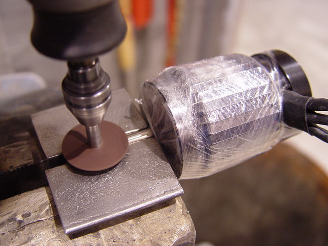

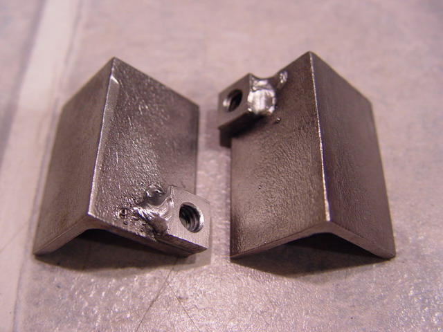

Here is a homemade jig for making factory quality flatspots

thats a nice idea...are the square pice of metal you have wielded to each piece of angle iron used to keep the shaft straight?
