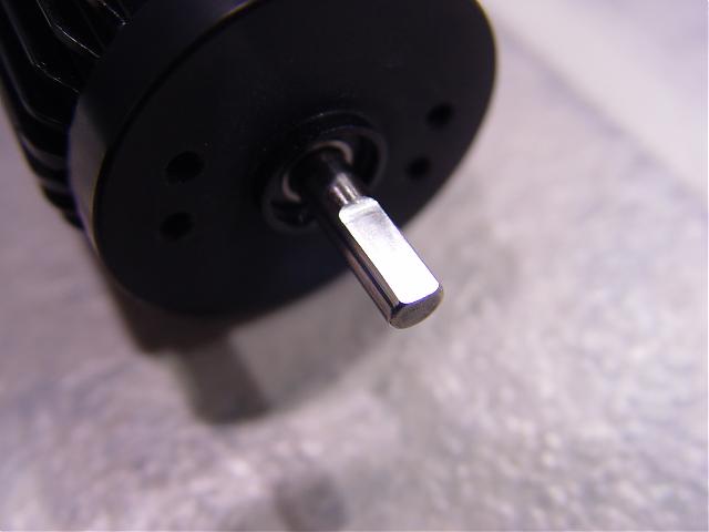

I always grind the shaft, and never use loctite. I have never had a pinion come off...so far!
I have only had one come off which is when there was no flat shaft. If you got a dremel it takes all of 3 minutes to do.
