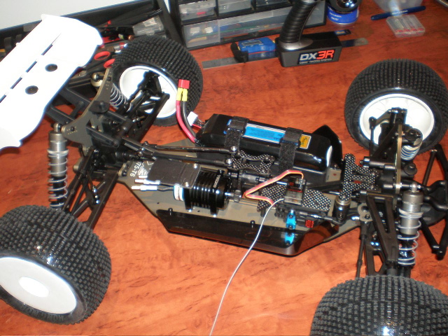

That's my X2 conversion Jnev .
I just drilled and dremeled 4 new slots in the chassis for the Tekno mount so i can adjust gear mesh .
Fits great , only thing because the mount is seperate from the diff ,when the chassis flexes it could stuff up the gear mesh so i braced the centre diff to the rear chassis brace which will stop the centre chassis flex .Pics below so you can see how i braced the diff.
I also have one of Mikes CR buggy mounts coming to try out in the X2
