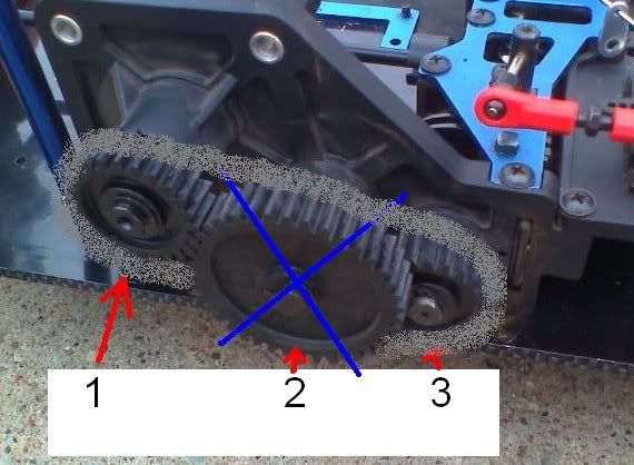

Heres a quick sketch of the belt idea... The 1st and 3rd gear would both have the same belt pinion to make it a 1/1 ratio on the tranny. 2nd gear would be taken out completely or used as a guide.
Ah ok. That will work well, but I still think that having an inline motor setup instead of transverse would be better. But whatever works best for you I guess.

If I decided you go directly to the diff I would have to make a bigger and more complicated mount and I would have to dremel the nice pretty aluminum playing that covers and holds the center diff in place.
