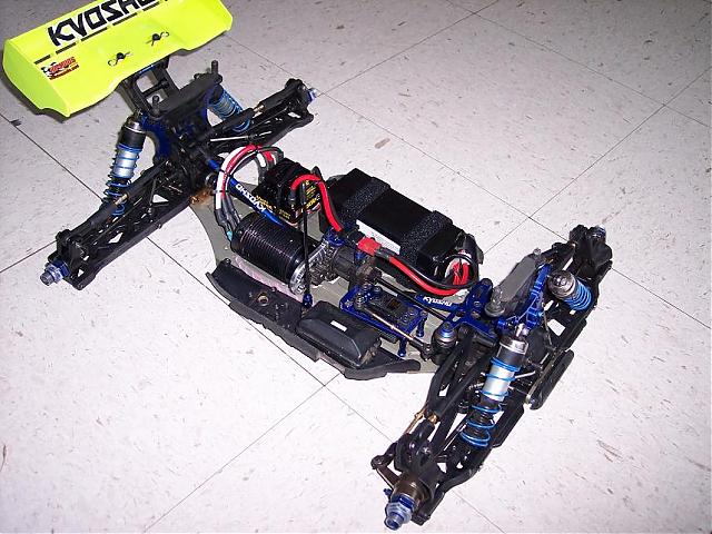

finished the MMM wiring and mount, i decided to raise the MMM off the chassis to help keep it out of the dirt so much, and to protect it from w/e can come through the holes in the bottom of the chassis. and its velrcod to the 2mm aluminum plate with 3M industrial velcro (will prolly put a zip tie over the top just incase). i havent setup the MMM yet but none of the females were touching the heat sinks to start off with but i bent the two fins in next to each one and slid some hard yellow shrink on them anyways. and in one pic youll see my battery jsut proped up in there to mock for mikes battery which i hope comes today with the tray and motor mount, if not ill be scrambling to get it together early as i can tomorrow after i can get the package off the P/O truck.
front to rear balance is 1.080 inches forward of center of wheelbase, left to right balance im still not 100% on my numbers but i believe its going to be 60/40 battery side heavy, it would have been 50/50 if i had mounted the MMM behind the motor but i didnt like it there.
