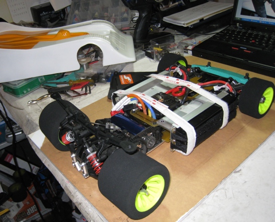

samwong
Posts: 19
Join Date: Jan 2009
Also join the 960 Brushless party - 02.15.2009, 10:19 PM
The only problem now remained is the motor selection....
tested that 19T P / 45T S gives 96deg cel. of motor, ESC is around 45Deg. cel.
Motor is 2350kv with 4S Lipo .... rotor broke ...
Thinking if it help....to use 2100kv motor to lower down motor temperature to around 70deg cel., anyone can give me a hand.....

  (#87)
Countryhick
02.16.2009, 04:38 PM
Looks great!!! I think you might want a better quality motor. Maybe try a NEU??
Well done!!
Cheers Andrew
  (#88)
samwong
Posts: 19
Join Date: Jan 2009
02.16.2009, 08:28 PM
Well done!!
Cheers Andrew
Thanks .. Andrew..
yes exactly ... I really need a serious motor... but in Hong Kong, it is hardly to find....finally yesteraday I got Losi Xcelorin 2100kv for my second trial.
And I will still keep the gear 19T p / 45T s and see how will the temperature of motor be...
May I know your motor spec (kv) and temperature after a continuous run? and how you compare 2gears system vs single gear system in 960 brushless conversion...in terms of motor temperature, acceleration and run time? as I still unsure if it need 2gears system for brushless... to achieve a comparable speed with other Gas Power 960. But seems now just use 2nd gear gives motor too much loading and temperature...( at least with cheap motor, hope Losi 2100kv works better)
  (#89)
Countryhick
02.17.2009, 04:42 PM
Originally Posted by samwong View Post
Thanks .. Andrew..
I'm using a NEU 1512 2050Kv. (but I run 6s LiPo) I think your motor KV will be a little low to achieve the same speed as a gas 1/8th, unless you can drastically gear up, which will possibly add to your overheating issues.
Because I use a large aluminum motor mount, the chassis of the car dissipates a lot of heat (this is how the gas motors also dissipate their heat) running temps are around 70deg C. (30deg ambient) This reading is after continuous running on the racetrack for 10 Mins. I see you have a CF motor mount and this could partly be some of your problem.
After running the car with a 2 speed, I don't feel that there are really any benefits. If there was a larger ratio change between first and second then there maybe an advantage.
Because I haven't tested with a single speed I can't definitively state if the run time is better or worse. I do however think there wouldn't be much difference.
Keep us posted!! It's great to see these 1/8 onroad cars popping up
Cheers Andrew
