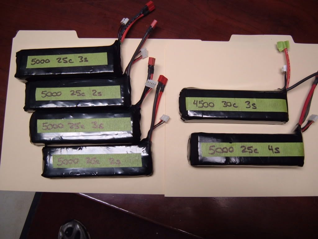

Here a quick pic of some lipos I just finished. The 4 on the lest are a broken up 10s pack- 2 2s and 23s packs. The other 2 were packs with one damaged cell that I removed.
