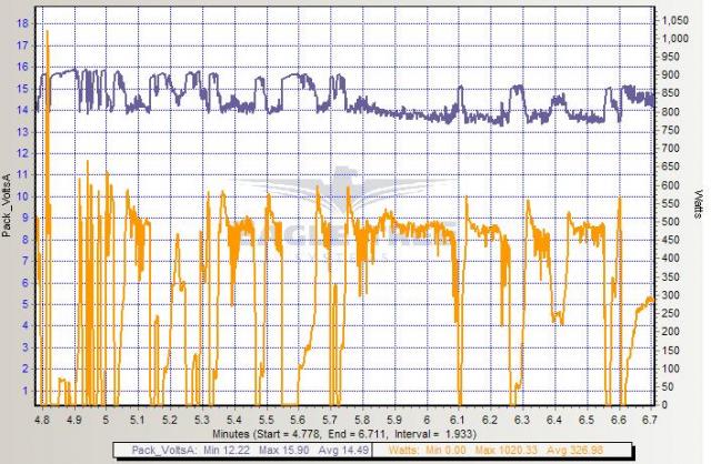

Is that 2000watts sustained? or bursts?
2000watts is quite doable with 10 cells sure, but I am just wondering about air flow... Example, I ran a 8s1p A123 pack in my lawn mower at 800 watts sustained, and even higher bursts (~1000watts), that lasted roughly 4 minutes, and discharged 2200mah (of 2300mah 'rated'). NOTE: A123 cells sure do put out their rated capacity, no matter the load on them.
Did you take a look at my eagletree graph I posted?

I don't intend on running 2000+watts, just an example of their capability.
I did check out the ET graph,was that on the mower?
